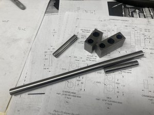

A lot of the crankcase parts were made of brass plate, 1/8" or 3/16" thick, and the heads were 3/4 'by 1 5/8" by 2" also brass. I had the steel, would have had to buy brass, it looked pretty expensive.
So I made it out of steel. I'm sure brass is easier to fabricate, but it's steel
IMG_1529.JPG Crank case parts

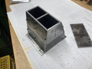

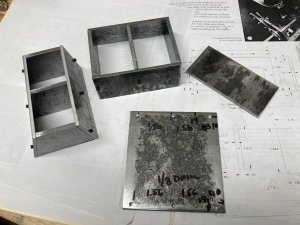

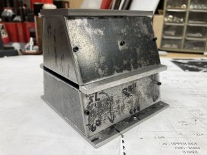

IMG_1540.JPG cylinder holes and access doors

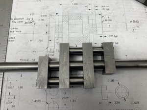

and I started on the crankshaft
IEZS5073.JPG I made the webs double thickness and then split them IMG_1552.JPG

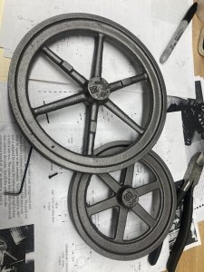

Flywheels came from Martin Models. I got a smaller one for the non- gear end because I think I want a generator to go there. The larger one is the one designed for the Nash, it's 7 3/4" in diameter
