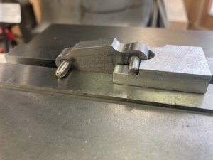

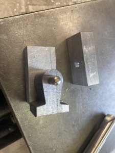

Connecting rods.
These are a little different from what I've made in the past, mostly because they are built up and brazed, but also because the ends are cast iron.
As messy as it is, I like the way cast iron cuts. The big ends are pretty standard. I cut a piece off of a scrap of cast iron and milled it to thickness, and width with a little extra length, drilled and tapped the bolt holes to attach the caps, then cut off the cap ends and milled them to length.
Same with the other piece. I had marked the pairs for orientation, but by the time they were correct length, some of the marks were gone.
Bit of a puzzle, but I got them sorted out. The top ends have a 45 degree cut off on the corners, so after drilling and reaming the crank pin holes,
I cut the corners off.
The big ends are 3/4" square. The small ends are .44" diameter on the ends, and taper to .31" at their bottom end, and are .595" overall.
So this is what I did. Started with another cast iron rectangle of correct thickness and excess width, drilled and reamed the two wrist pin holes, 1.375 " apart for plenty of extra, then rounded the ends on the rotary table.
I used the part like a tiny sine bar to mill the taper on the part, then cut it in half, drilled the holes in the end.
It took a little fixture to hold the parts vertically so I could drill the end holes
"Oops, we ran into some problems" no more room.
Continued below

To continue,
I used a piece of brass rod to align the two parts, and the wrist pin holes to suspend them in the vise,
Milled half way through and to length, then flipped it over to finish
Next time I'm brazing, I'll make a little holder for length and alignment and braze these together. There was probably an easier way, but this is what I came up with. Probably could have done it all on the rotary table (little ends) but the angle was 9.7 degrees for .375 inches, and I wasn't seeing a way to make all four of them the same that way.
Thanks for looking,
Doug
