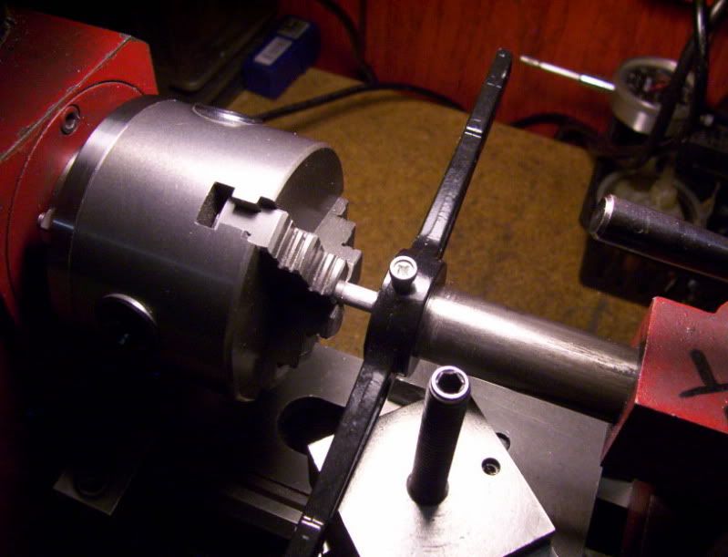

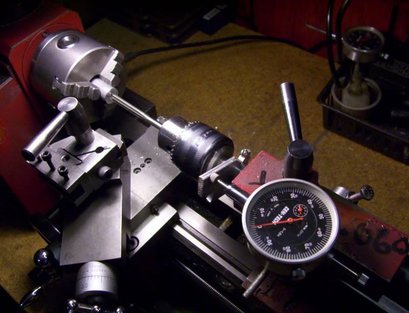

This jig must support the rod along its entire length, as best as possible, so my design uses a solid rod, and a top plunger, spring loaded.

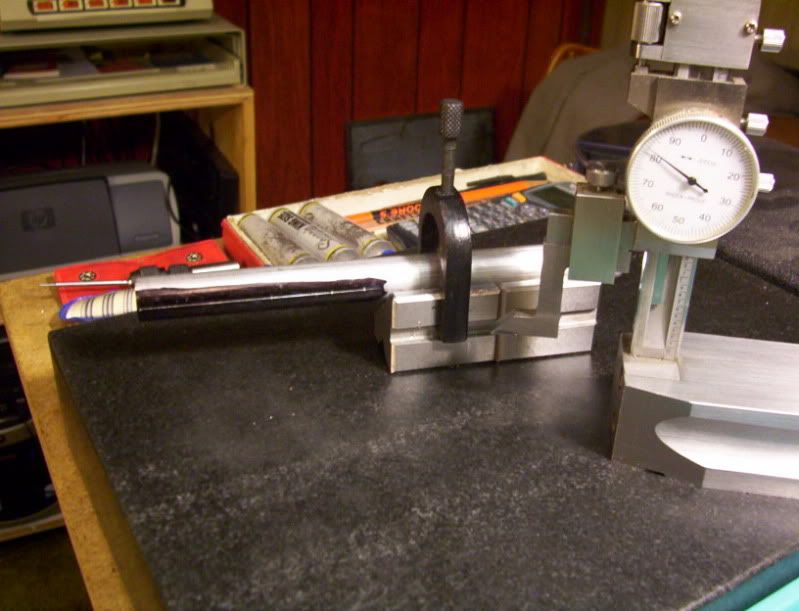

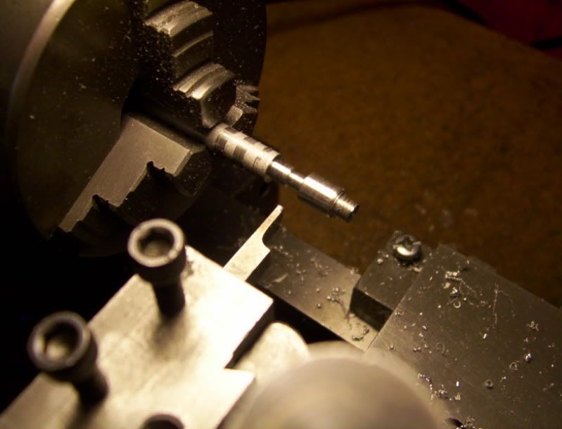

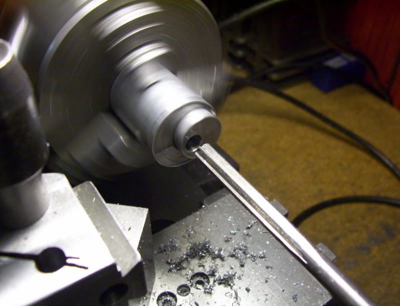

I start out by machining a 5/8"dia. rod to 4" overall length, measuring the length of the spring and its inner dia. shows I need to maching a stem on the end of this rod 5/16" in diameter, for a 1" length.

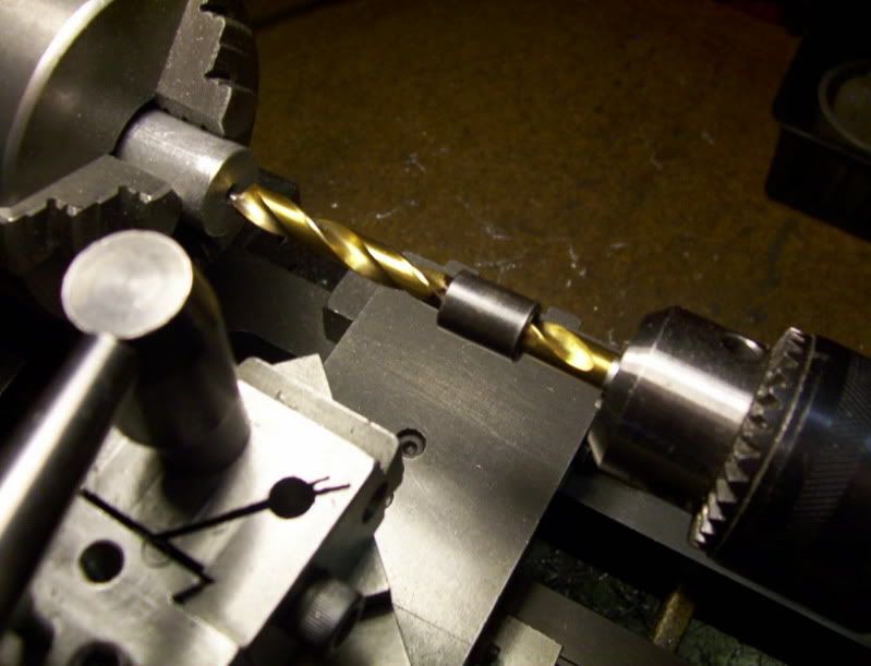

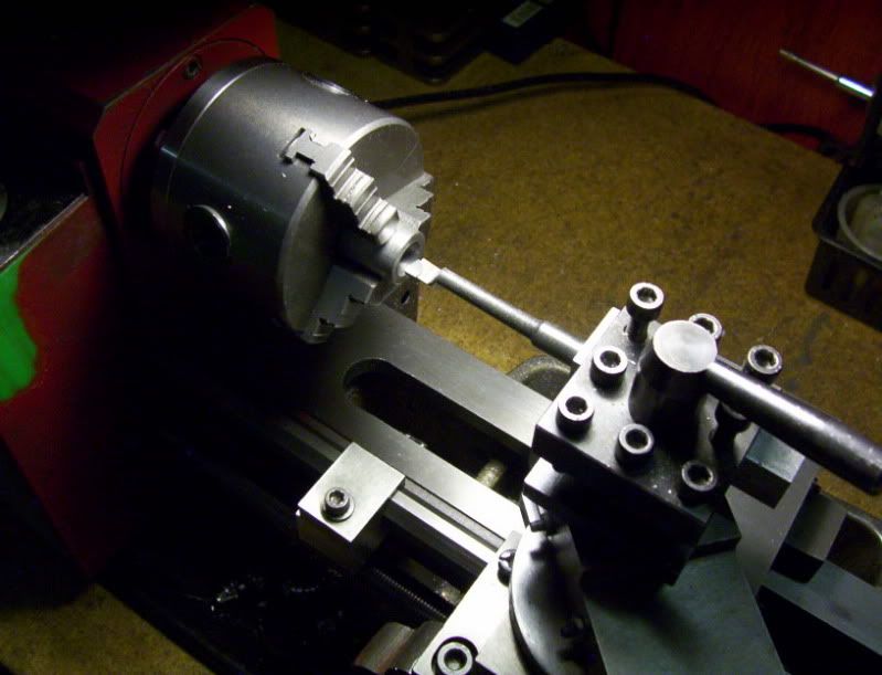

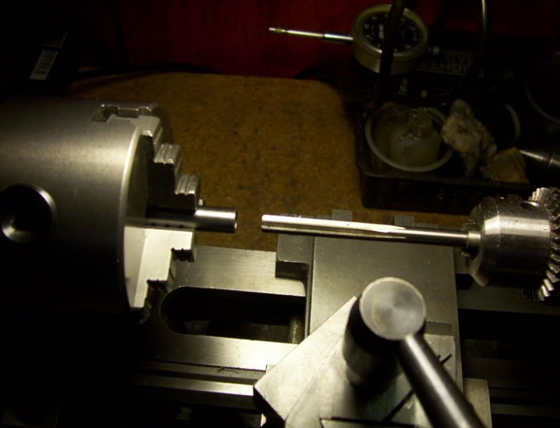

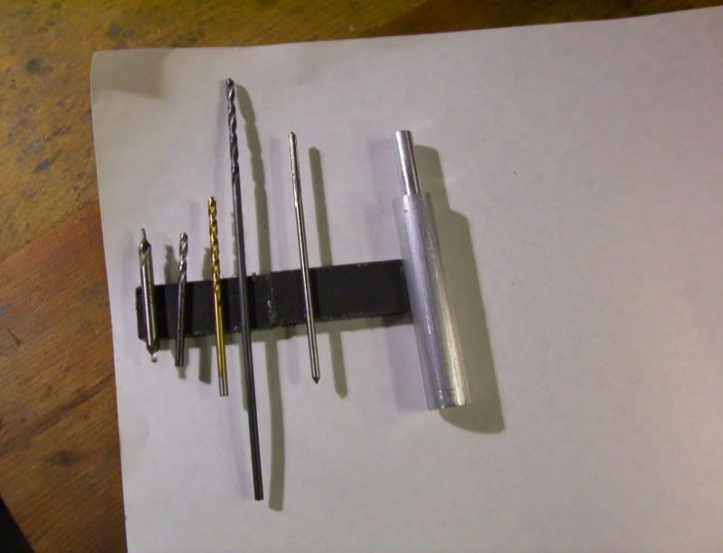

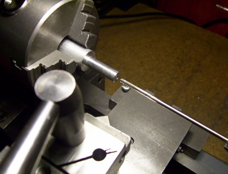

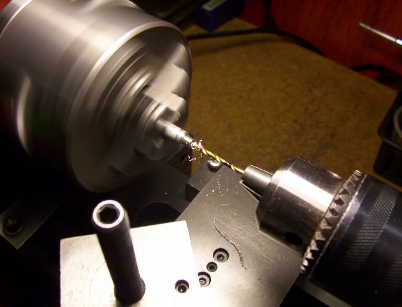

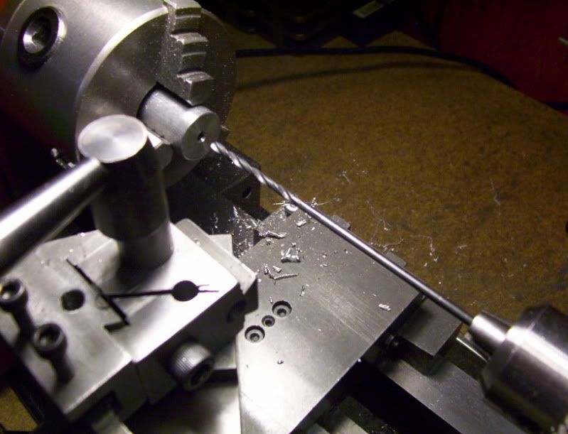

Now to support the 1/8" dia. drill rod its entire length I need to take my time and precisely drill the work piece with a thru hole of 1/8" dia., then finish it with a 0.126" reamer.

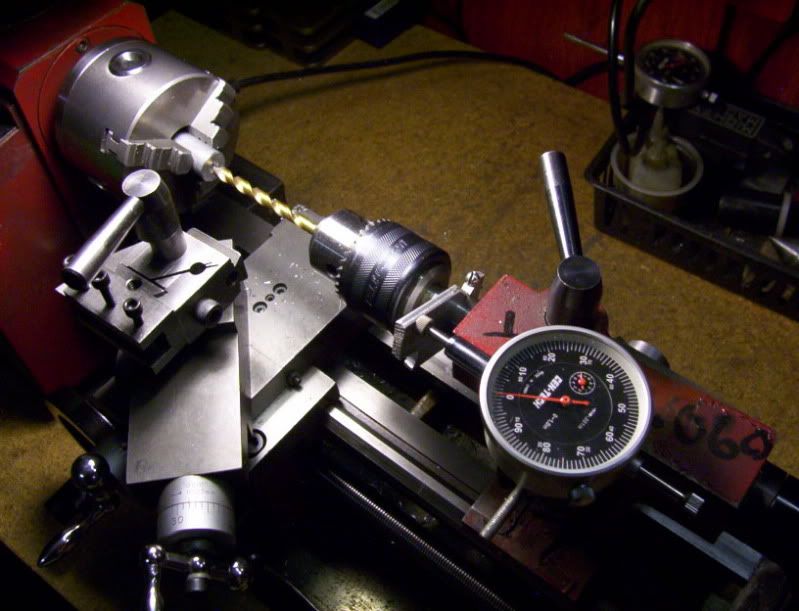

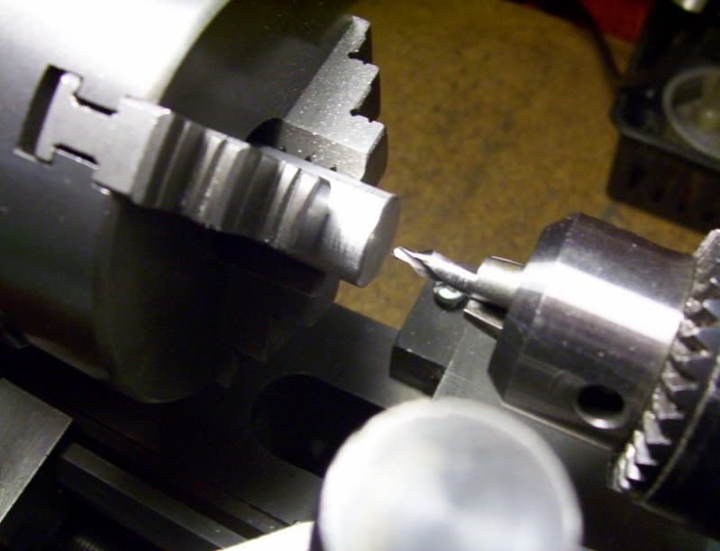

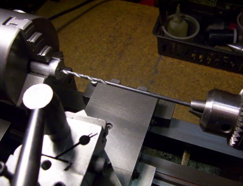

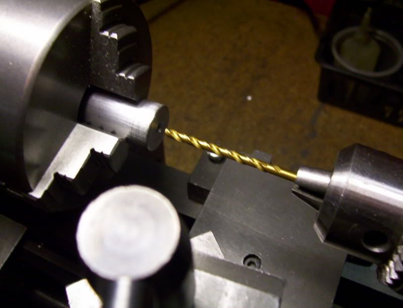

So I need to use my smallest 1/8" screwmachine size drill bit, followed by a 1/8" jobber size, finally following that with my 1/8" aircraft size bit.

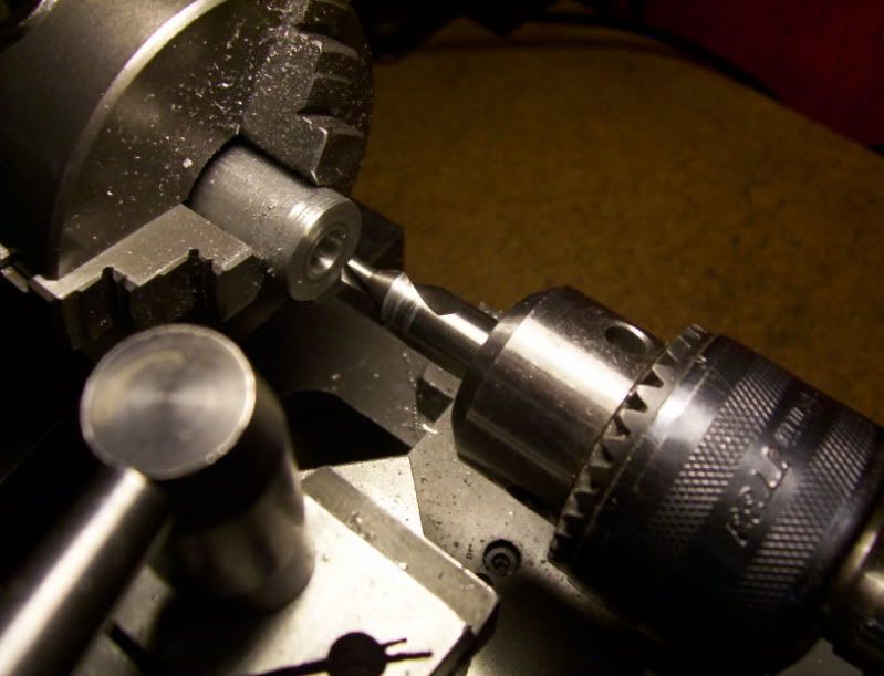

Now I'll ream it with the 0.126" reamer as far as it can go.
Before I take the workpiece out of the chuick to turn it around to finish thru with the reamer from the other side, I need to drill and ream for a 0.249" hole 1/4" deep at the bottom of the workpiece.
Now I can turn the workpiece end for end to finish the reaming thru the workpiece.
Now here it is with the thru hole as precisely as possible drilled and reamed through, and the spring that will slide on top of it.

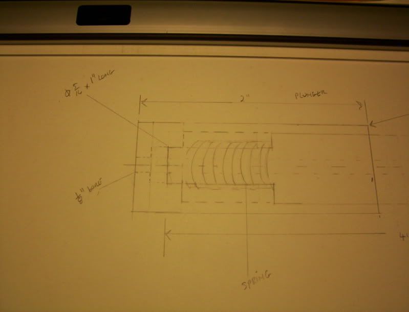

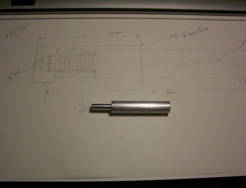

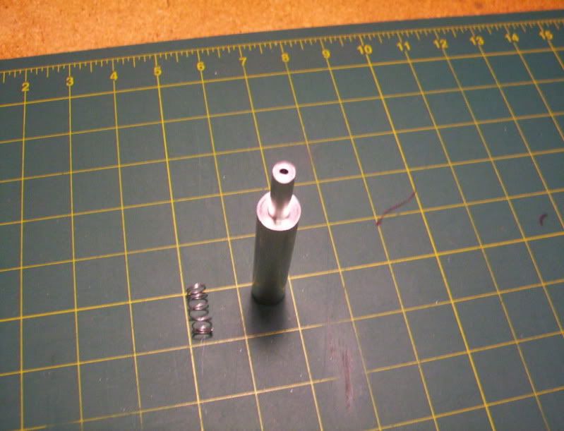

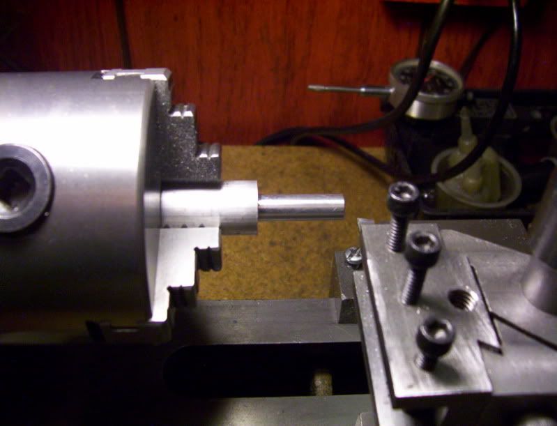

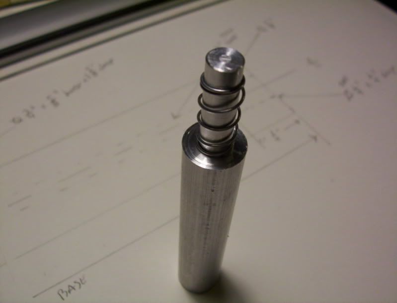

Now its time to make the top plunger, that will rest on the spring and glide over the base and have a stop after it traveles for 1/8". This plunger will be 2" in length.
Here is the plunger blank machined to final length of 2"
And the drawings for the dimensions.
this will be done in 3 phases.
The first will be a thru hole 1/8" dia.
after that I will drill a 19/64" hole 1-7/8" deep, followed by a 5/16" reamer.
phase 2, I need to drill a 1/2" dia. hole 1-5/8" deep.
Phase 3. now bore this hole to a final insde dia. of 5/8" - 0.626" by 1-5/8" deep to make a sliding fit with the 5/8" base previously made.

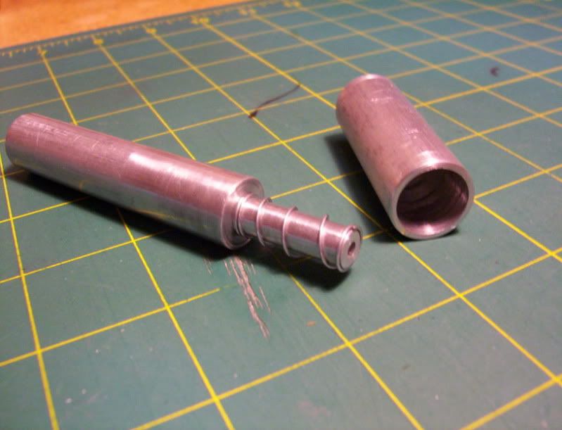

Now the parts before assembly
And the jig in it's final assembled stage.

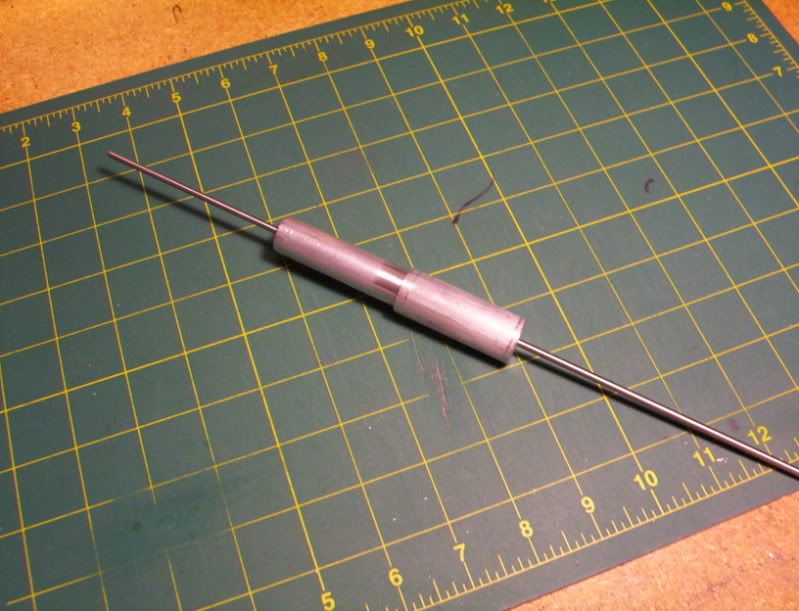

Now a 36" drill rod 1/8" dia. is slid through this jig, to test the accuracy of the assembly.
it slides with no excessive play along the entire length of the drill rod, very presisely done, so this may work in supporting the rod from bending during a press operatiopn.
The way this should work would be, the machined piston will be loaded at the bottom of this jig, then a 1/8" dia. drill rod machined to exact length, will be loaded at the top of the jig, the top of the rod should be just about flush with the top of the plunger cap, that is resting on the spring, now placing the jig under my small manual press, I should be able to press the rod into the piston, for an depth of 1/8" before the plunger hits its stop thereby keeping consistancy with every pressed rod. The spring does nothing more than keeps the cap plunger around 1/8" floating above the base stop. Thereby preventing any bending to occur imediately at the top of the rod where it will be pressed against.
This completes the first part of this project,

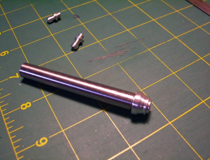

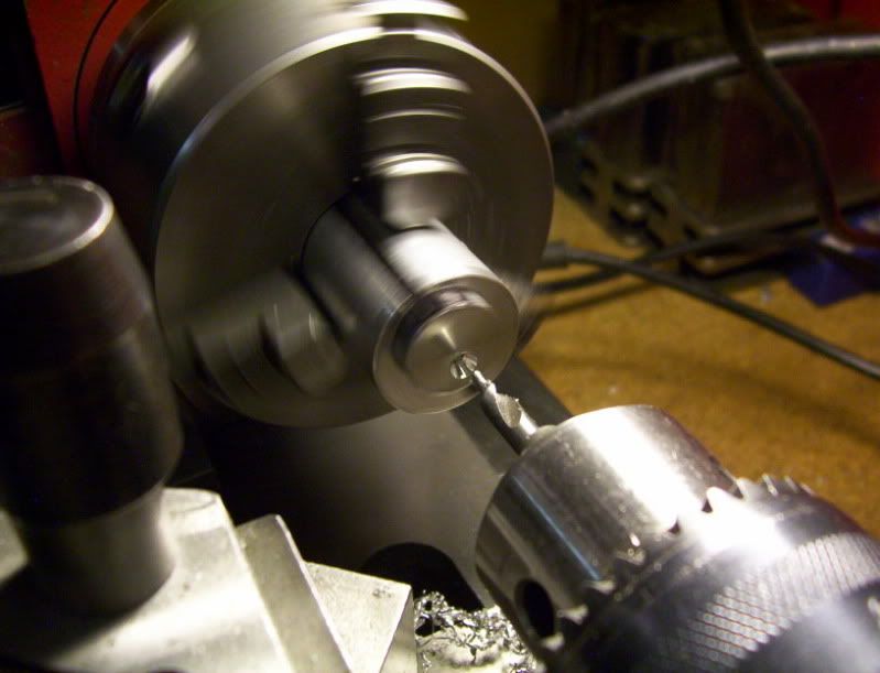

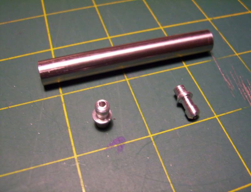

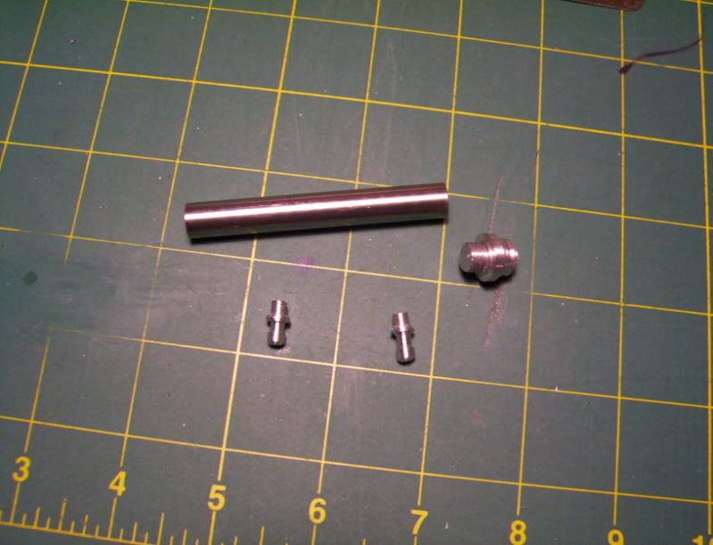

Today I started working on the hose bibs, for the cylinder, the tubing I have available is 1/8" inner dia. so I made the bibs, from 1/4" alu. rod, and formed a spigot to put a 10-32 thread at one end.
then drilled a 5/64" thru hole for the fluid inlets.
Then I began working on the top end cap, the cylinder is threaded at the top and bottom with a 5/16-24 tap. So I measured the tap I used and got around 0.320" for the outside dia. then the spigot on the cap is turned to that dia. for around 1/4" length, later it will be reduced to around 3/16".
Next I will work on the bottom end cap, then drill and tap for the 2 hose bibs,

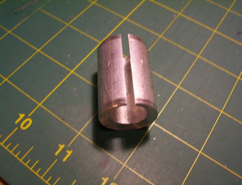

To machine the cylinder in this fashion, requires a homemade split collet to be able to hold a 5/8" round bar offcenter by 1/8", and have it be used in a 3 jaw, self centering chuck, on the lathe.

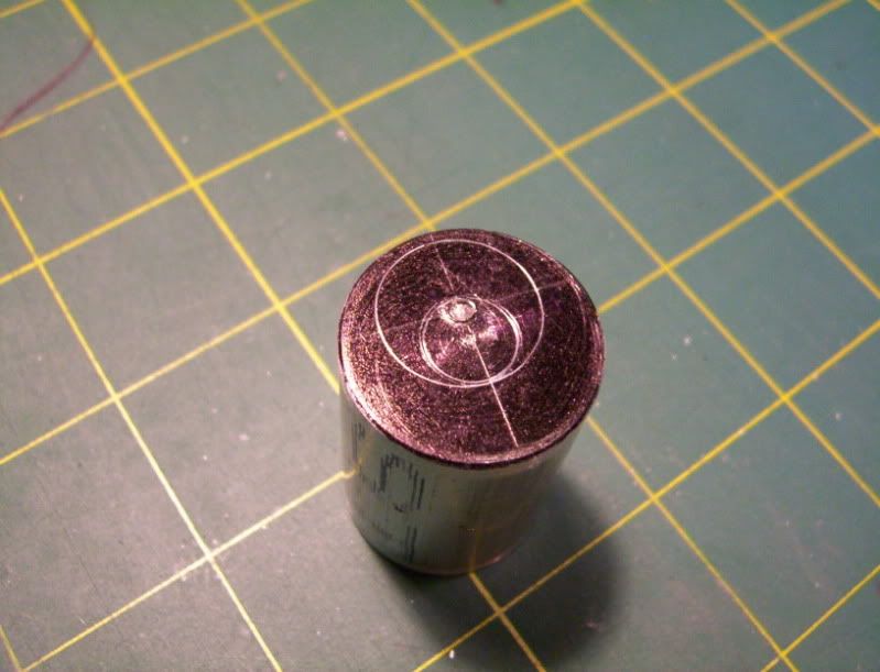

The 5/8" dia. cylinder stock, I'm scribing a centerline, for locating in the collet.

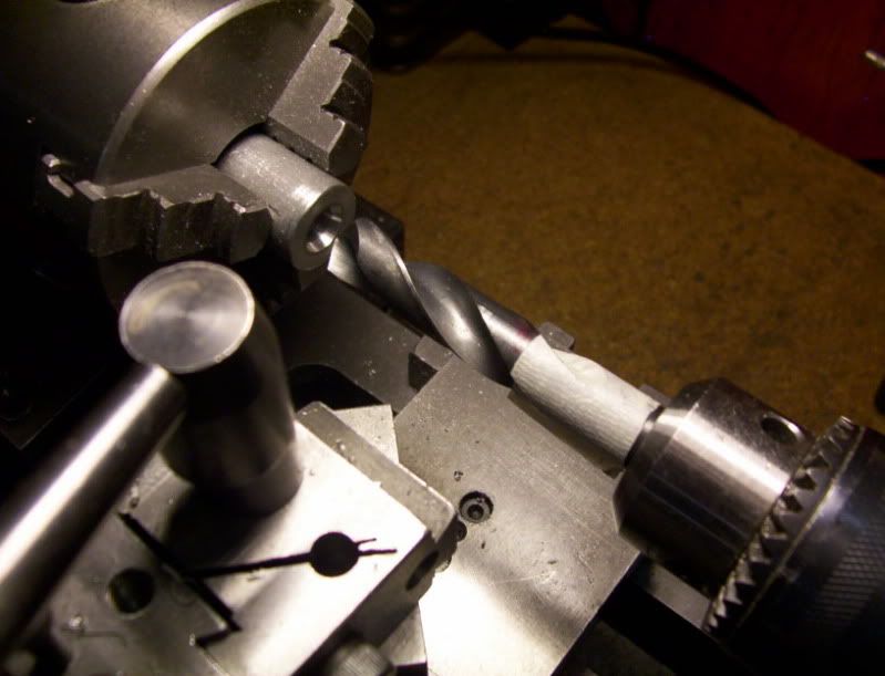

Now I am beginning the process of drilling and reaming the inner bore to 0.249".
No that the cylinder bore is done, I need to loosing the collet and slide the work piece out so it can be machined, this is why the centerline was scribed earlier, so as to have a locating reference for the collet.
The finished workpiece, after the eccentric turning in the lathe.

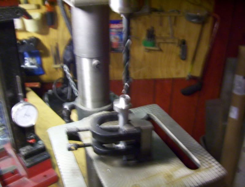

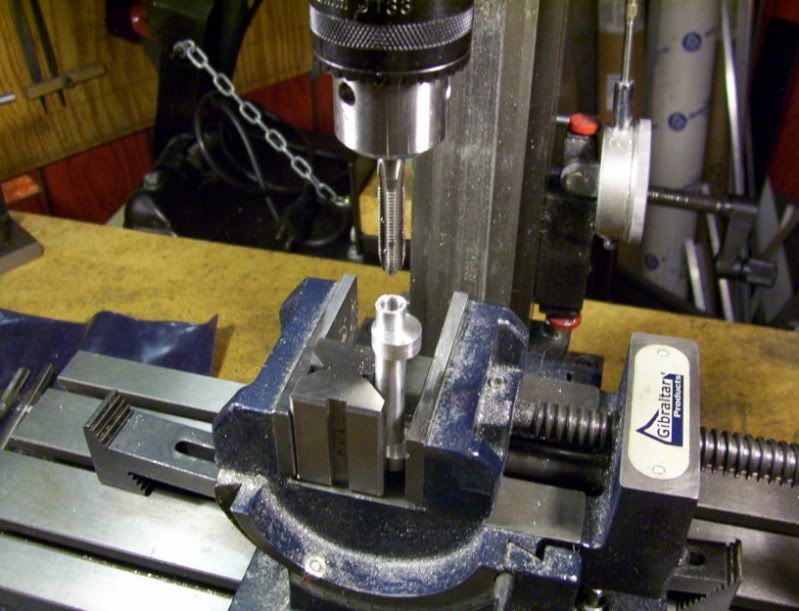

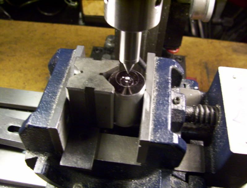

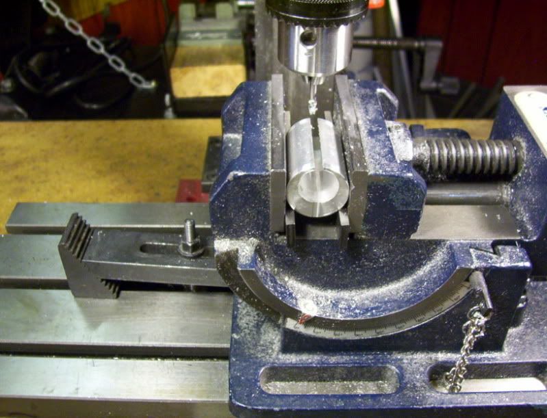

Now I clamped the workpiece to a V block, and drilled 1/4" deep hole for a 5/15-24 tap, on both ends on my drill press.
And then put it in my micromill-drill to line up and tapped the hole 5/16-24 both ends,
these threads will be needed to be able to put endcaps on both ends, of the cylinder.
And the final work piece (cylinder) before the machining of the tube connectors.

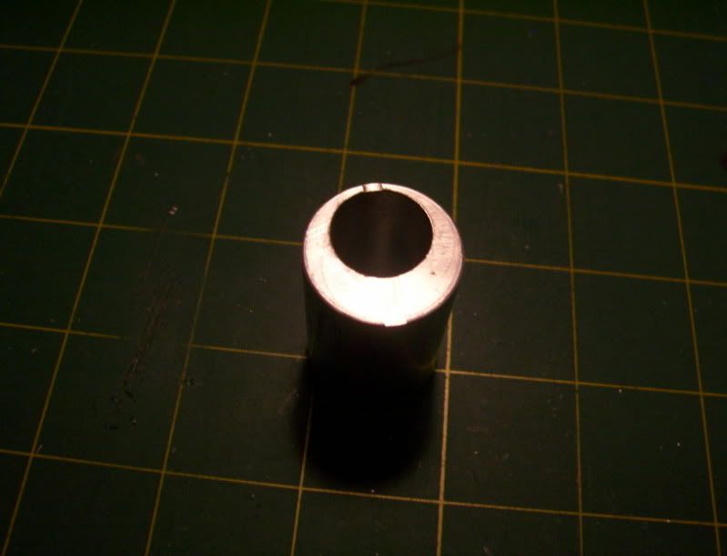

These are the 2 failures in making a fixture for holding the cylinder for machining the tube connectors in my lathe.
The first one failed because of a poor design to start with, it was made to act like a split collet to hold the cylinder stock sideways for machining, the failure with it is that this collet will not cinch properly, due to the square walls, milled into the collet.
This second one is a succesful design concept, it works perfectly for holding the cylinder stock in position for machining, the failure is with the size of stock I used to make it, the clamping screws are to close to the area that needs machinied therefor not enough room to bring the lathe tool in from the side to take nice cuts.

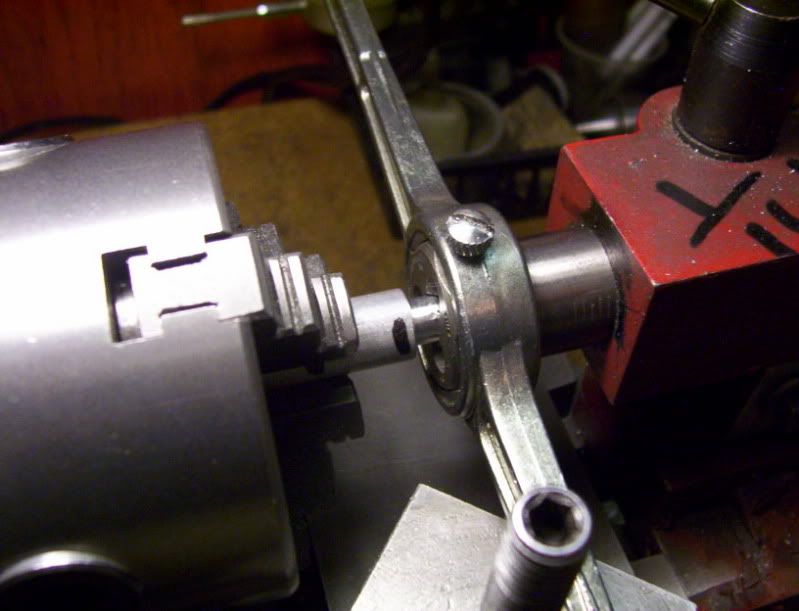

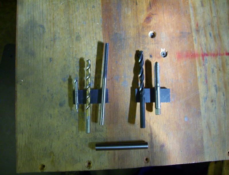

First I rough the length of a 5/8" dia. round bar to 4-1/2",
When I drilled and reamed the last time I had to drill and ream a blind hole, because I had the parent stock in the collet, which went further in length than my reamer could handle.
This time I set the workpiece out to around 3" overall working length,
And only drill a center hole for my tailstock center,
That way there is no need to loosen the collet and pull the workpiece out and realigning it as I did the first time.

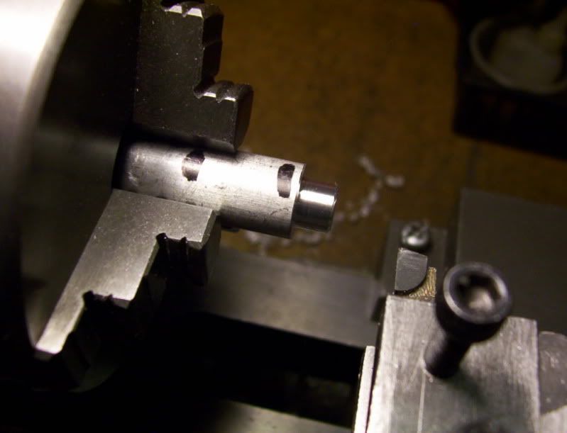

The workpiece is placed in the collet for all outside machining first, so I mark off the areas needed to be machined,
Then starting out with my cutoff tool I begin to cut these marked out areas to the specific depth,
Then change to a heftier tool, and take almost the entire depth of cut, that way it eleiminates most of the interupted cutting ,due to the offsetting of the center of the workpiece, then after that I take the final finishing cut.
Now I can remove the work piece from the collet, and grip it in my chuck by the 3/8" turned down diameter (center of cylinder workpiece blank), and using a hack saw cutoff the parent stock, which was being held by the collet.

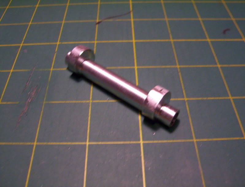

By doing it in those steps, I am now able to drill and ream the workpiece all the way thru the cylinder blank, eliminating any heavy build up of chips when reaming the blank.
So now I drill and ream, the blank to it's proper inside dia., with a thru hole.
Afterwards I can now drill and tap each end, of the cylinder blank.

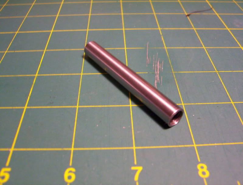

And again the finished cylinder blank, ready for the next operation. Notice that the hole is more concentric with the rest of the workpiec dia. because of drilling it in my lathe, instead of holding it and drilling in my drill press like I done before.

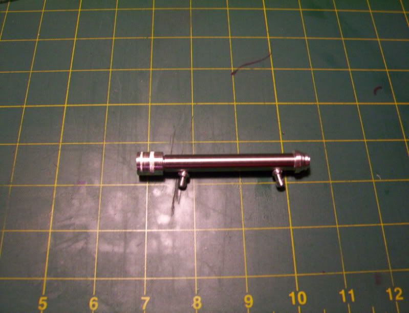

Ok todays progress, I decided that to make a fixture for holding the cylinder in the lathe, may not be nessary, because that would mean more steps involved to get an acurate setup, so I opted. to build a tooling instead, so all the work in drilling the connector holes and machining the connector itself, can be done all in one setting, in my mill vise on my milling machine.
The tooling I made is sort of like a plug former, rather than a cutter, because it forms a cylinder shape from an already squared shape.
Here is how I made it.
Took a piece of tool steel, 3/8" dia. and after the usual lathe work of getting it prepared (facing both ends), then I drilled a 3/16" hole, about an 1' deep. (this forms the spigot which the tube connects to)
Than followed that with a 1/4" bit for a depth of around 0.1" deep, (this forms the base of the tube connector form),
Lastly in the lathe, I made a taper using a center drill, (to give a gradual entrance of the tooling into the workpiece.
Then over at my mill I milled a flat on both sides to a depth to expose the slots that are formed by the internal drilling. (this gives a lot of chip clearance.
Now a piece of scrap, aluminum square stock 1/4" is in the vise and a cut is made with this tool to see how well it performs in cutting a cylindrical stud.
My camera only takes 30 seconds of video, so the finished workpiece could not be televised, but here it is starting to cut a stud from the 1/4" square piece.
Next I will work on the cylinder and use this tool hopefully, to machine the tube connectors on it.
I drill the inlet holes first, this alsop allows me to use these as references if need.
Then I mill away the material on the sides to make a 1/4" square nub, ontop of the cylinder.
Now I use my former tool to machine the spigot on the cylinder.
Once both sides are done, I then return it to my lathe to do a clean up pass with the reamer, to clean up the fragments left by the drilling operation.
Here is the cylinder at this stage, with both tube connectors machined onto it.

Now that I have a technique, to machine a inlet port nozzle onto a workpiece, without making them seperate pieces, your mention of putting the hose ports on the end caps, is begining to look more promising, since it's not threaded in seperate, it won't take up as much room, so I can shorten the cylinder to accomodate putting the inlet ports on the endcaps.
Right now the way I'm thinking I could do this, would be to turn down a spigot on a piece of 3/4" round bar, then thread it to the required 5/16-24, that would then leave around 1/4" left of the remaining dia. above the spigot, that can be machined to the required 1/4" square, followed by the former tool, directly on the endcaps.
That way there would be no need to machine the cylinder from 5/8" stock, but now I could use the 3/8" dia. stock.

I now have the piston and rod assembles, as well as temporary endcaps installed, and tested it out with blowing through the tubes on both ports, and the piston works fine with good compression.
I know I have a good seal on the top endcap, because when I put my finger over the top inlet port, and blow air into the bottom port, the piston moves very slowly, but if I rem,ove the blocking of the top port, the piston snaps out very quickly with little air pressure. That tells me that there is a good seal at the top, because the piston is having a hard time exhausting air as it is moving. So succesful design as far as air preasure working the piston back and forth, smoothly.
Now that I know this design will work, I will look at rebuilding the whole system, by machining the intake ports, as one piece on the endcaps, that will be the next experiment in this build.
Time to assemble the piston to the rod using the press jig I made earlier in the build.
This is the cylinder and piston assembly, with temporary endcaps,
here I put the top endcap on tight and then drill and ream the 1/8" hole for the rod to pass through.

I'm using 1/2" dia.alu.round, and reaming a 3/8" hole, with a 1/4" hole through the top endcap, for the piston rod. This piston rod assembly will be one piece from a 1/2" stock turned to proper diameters.
For anyone NEW to this hobby, here is a quick procedure if you need to make a cylinder with a cap on it and the cylinder bore needs to line up concentric with the hole in the cap, for a piston rod to pass thru, without binding.
First I machined the endcap and threaded it to mate with the cylinder.
Turned down nub for threading.
threading the nub.
then after cutting it off, I wrap plumbers tape around the threads.
Then set it aside and begin machining the inner bore of the cylinder with a thru hole,
drilled and reamed to proper inside diameter.
Keeping the cylinder still in the lathe I tap the mating thread into the one end of the cylinder.
Now with the cylinder completed on that end, keeping the cylinder still in the lathe, I screw on and tighten the previous ly made endcap.
Then I do all finish machining to the endcap, such as facing it to length, and any decorative turnings to it. In this machining process the endcap continues to tighten more and more, as the cutter makes contact with it. Also if the 2 pieces weren't threaded straight, when put together like this they can have any iregularities machined out, so it all ends up concentric.
Now after all the machining the profile is done to it, the endcap is as tight as it will get hopefully giving a good seal, now its time to drill and ream the hole through it the proper dia. for the piston rod to pass through.
If done properly the rod hole should be very concentric with the cylinder bore so as to have smooth piston movement, with a fairly good seal with the rod and cap.
The before and after of the top cap and cylinder assembly.
After both these cylinders are to this stage, I can then put the cylinder back in the lathe, with the bottom sticking out to tap the threads for the bottom caps.
