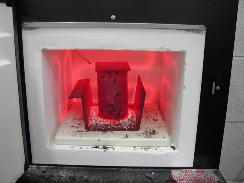

To be successful in this process you must understand some peculiarities about this process. Normal casehardening involves nothing more than immersing a low carbon steel object inside a carbon rich atmosphere and than heating to above critical temperature. The longer the object remains in the pack surrounded by the carbon the deeper the resulting case will be. Temperature also plays a role in this as the absorption of carbon is quickened by the higher temperature ranges. The parts can simply be taken out of the pack and quenched and the casehardening will be successful as long as the part is quenched before it cools to below critical temperature.
Color casehardening requires more care. In color casehardening the parts need to be immersed in the carbon material in a sealed container and the temperature is critical for if it is too high the colors will be poor and washed out. Few people know it, but it is actually possible to get very good colors under the critical range; however, if this is done you are not really casehardening, just coloring. I have found that temperatures should be close to the 1400 degree F mark. When the temperature climbs much over 1450 the colors seem to be rather poor. Just as important is the process used to quench the parts. If air contaminates the parts before they hit the quench the colors will be spoiled. For this reason it is very important to make sure that a method is devised to allow the parts to be moved directly from the crucible to the quench as quickly as possible. For this reason I have devised the following crucible seen in the photograph below.

This crucible makes use of a length of 3 diameter steel pipe (stainless would be much better) with a cap welded on one end. The other end remains open. A pipe nipple is welded to the middle to allow gripping with a pair of tongs. The crucible is loaded with the polished, degreased parts, and packed with the chosen ratio of wood to bone charcoal. We have used different ratios, but most of the time I have settled on a 1:1 mix of wood to bone. It is important to keep the parts from touching the sides of the crucible by about ½. Add the charcoal in layers, tapping the crucible at regular intervals to settle the charcoal but do not tamp as this can pack the parts into the crucible so tightly that they can hang-up during the quench process. Make sure the charcoal is all the way to the top and then level of with a flat bar or stick. Next the crucible is inverted on a stainless steel carrier and any extra charcoal packed around the sides of the crucible. You can see this clearly in the above photograph.
The crucible is than placed inside the furnace
![Onehotcrucibaledited.jpg](https://proxy.imagearchive.com/aa0/aa083da40652f6c3167ce2d3702a2f7c.jpg)
Meanwhile you should prepare the quench. I generally just use plane water that is as cold as I can easily get it. I shoot for a water temperature of 35-40 degrees F. I generally accomplish this by putting a block of ice into the water a couple hours before I start the oven. At this time I also supply air to the tank via an airline that runs into the bottom of the 32 gallon barrel that I use for quenching. See the photograph below for a picture of an older tank that we used to use. Some texts suggest placing Potassium Nitrate into the water to increase the colors obtained. I have experimented with this and have found that it does indeed provide more blues, but more experimentation is needed in this area. Basically I think there are two main variables that are important here. Water temperature is one and oxygenation of the water is the other. I think that is far more important to run the airline into the water before the quench than it is during. At some point I will obtain an oxygen monitor to measure the oxygen content of the water as I think this could provide some interesting answers.
