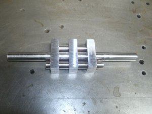

I started with the crank shaft making it the same way I had done on the other models but I soon found out that a two throw crank shaft is immensely more complimented that a single throw crank. After several failed attempts I decided to try this method.
It is made of six pieces, three shafts and three bars. These were assembled with a close fit and red lock tite and left over night.
Next day the shafts were further secured using 1/8" pins through the bars and shafts. Next was to cut out the bits I didn't want and do some shaping of the bar ends and a coat of paint.
The crank ended up very true and it even looks nice.
