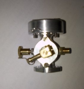

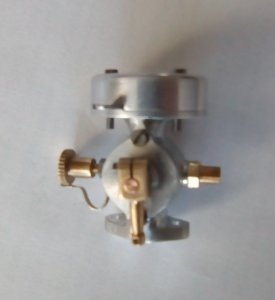

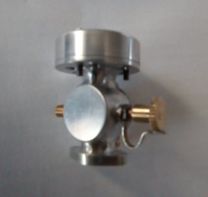

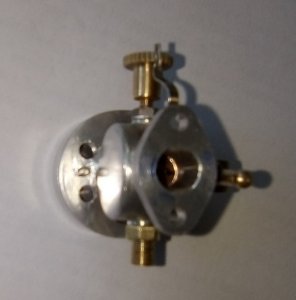

Hi I have not posted this as a blow by blow way of building this engine, just done the photo's to give some idea
Jan, 2020 I decided to go for the sealion but with no castings, so the drawings and ETW's notes from 1959 Model Engineer mag's were purchased from Hemingways and upon arrival started to do a breakdown on CAD to see what metal would need removing from bar stock to achieve each part ready to make a start on machining.
Then the lockdown started so I had to self isolate in my workshop (that is what I told my wife Ha Ha

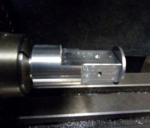

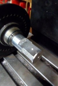

First was the crankcase I ordered a 6" length of 3 1/2" square, faced the ends and put some datum lines on.

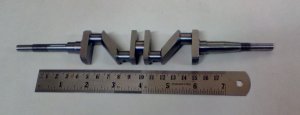

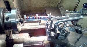

Next was the crank machined from EN16t

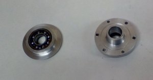

Then bearing endplates
Next was the cylinder head
Cam plate
Cam jig
Cam
Rockers (that's another story )
Carb
All the machining was using my lathe or mill.
I will put some more pic's up when I have some more time
Paul

Nice work. How did you profile the outer block shape?
You are obviously trying to replicate ETW build. I was thinking of doing away with the gear drive to the cam and using belt and pulleys. I also had real problems with the original distributor so triggered the ignition from 2 magnets on the crank pulley to hall switch.
Graham
Hi Graham
The out profile I had to mark out where the ribs were and the mounting lugs.
then mark out the profile on one end then it was onto the mill with a rotary table and tailstock and then roughed it all down with a 1/4" ripper endmill then for the last 20 so thou used a 3 flute endmill to finish then blend with a fine file.
