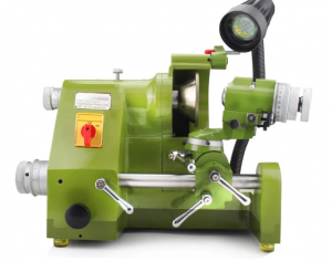

Similar problem like in the recent milling machine thread? Only difference I am upgrading from nothing to maybe giving it a thought.
A grinding machine for sharpening tools. I was considering this Hemingway Kits Quorn Mk3 - Universal Tool & Cutter Grinder a fun project for sure, but not very cheap. (it is what it is, not intended as complaint )
Dbitgrinder.pngA running machine like this is in the same price range as the Quorn kit. ( it comes with the work done, and without the fun of making it. And I think the quorn looks nicer on the shelf :) )
Question: are these two comparable? If I understand it correct the green thing is a copy of older German Deckel machines, that are if useable more expensive 2nd hand.
Now I stumbled into this.
It is about two thousand British Money. 3.2 x as expensive as a quorn unfinished kit. I guess shipping for the Kit will be in the same range as shippig the white Japanese colleague.
It says it is a "nihon seimitsu Co.Ltd" EG-100. I was not able to find any internet information.
Now I wonder if anyone has a comment. I do not have any more pictures, information or whatsoever. I am going to visit the machine on Saturday. Any suggestions what to look for are welcome.

Yes and how long is a piece of string?
IMHO it all depends on what on what you want to grind. It is possible to get a tool to sharpen lathes tools and the ends of milling cutters and work from the excellent plans from Eccentric Engineering or buy a set of plans for thr Tinker for about???? 80 Canadian dollars or - literally the sky being the limit.
You can buy a Chinese Deckel clone and -limited.

yes more a general invitation to share thoughts. And the hope to catch some comment about the mentioned items in general.
I am curious if anyone has an idea if 2000 dollars for a grinder seems reasonable, or overpriced.
I was asked if I was interested yesterday and thought I might find some comment.
Is the Bonelle similar to the Quorn? It looks nice anyway.
I was hoping someone can give some hints about what a Deckel clone can not do, that a Quorn grinder can do.
Maybe someone here owns both and has certain jobs that are better with one or the other?

I have the dekel clone d bit grinder only problem I have is in the first set up step for any job put the white dot in the white dot window there is no white dot there is no window. Both Robin Renzetti and Stephan Gotteswinter have good vids on the deckel clone. The adapter to grind lathe tools is ordinary good for 25mm stock I have made up adapters to suit the adapter for drill sharpening is cumbersome but it works
I paid about $1200 au has a diamond wheel as standard imperial and metric collets but no .125 or 3 mm collet I purchased mine to do small bits instead of forking out$40 plus for end mills so a 3 mm collet would be handy
I have an ER11 collet holder with a straight 16mm shank. it is handy for holding small stuff in the lathe 3 jaw chuck and i also use it in the dekel clone. i have collets up to 10 mm for the ER11 and 10 up in ER32. the ER11 can also go in the ER32 square and hex blocks. cheap ebay from china, most have a long shank but you can cut a bit off.
hi Couldea
I note that you have a 'Deckel clome'
As I am disappointed in mine-namd others i the past have similar expriences, please tell me what the Chinese affair can do.
The decke WAS designed to sharpen engraving tools but can be pushed to sharpen lathe tools and the ends of milling cutters. Can it actually MAKE mullung cuters which was really the intention of the Quorn and go up to say 1400 rpm and regrind dies and sharpen taps----and possibly be pressed into service to grin-- on the milling machine?

I have never seen that machine! If I found it for that price, it would be in my garage! Sure would like to know mor about it, looks like a great machine.
I think we are missing a word here. The Deckel is a very fine tool and cutter grinder. ( and as mentioned was primarily for Deckel milling machines and single point cutters- but it does others )
The Ops photo and the Quorn , are "universal" cutter grinders. The range of a universal cutter grinder in making various tooling is very broad and includes all types of special cutters, not within the Deckel scope. Deckel collets for example are narrow in range compared to 5 C or other collet types, so tool holding becomes a requirement that needs to be reviewed
So in deciding which to choose, one must look at the work in hand---or planned.
