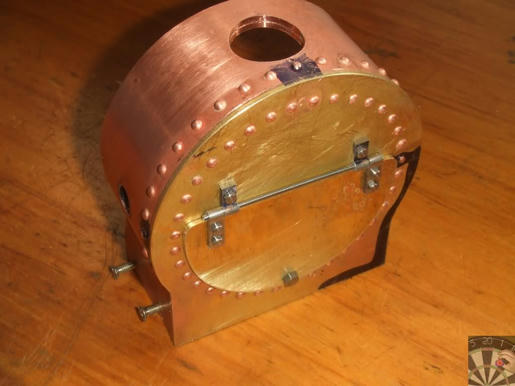

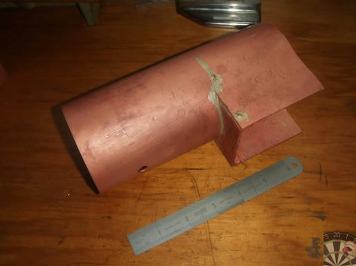

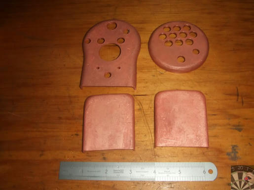

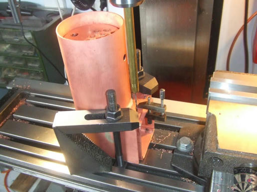

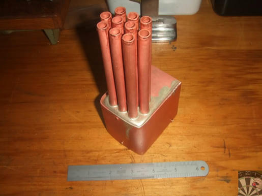

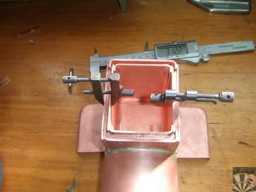

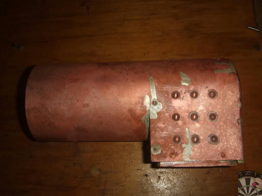

Since I did my first basic boiler last year I've always fancied making a 'real' locomotive boiler. The problem is that the materials are expensive and a cock up can be painful. I then stumbled across the boiler for the Northumbrian serialised in ME in 2009.
http://www.model-engineer.co.uk/news/article.asp?a=6974
Its small and based on 3" tube, which I had in stock. I also had material for most of the other parts so decided to give it a go. Here is progress so far.
Its going pretty well and had been a bit cautious about doing the bushes so have left them to last. I probably should have done them first.

Jason you'll recall you put me straight on the drawings fiasco over on the ME forum, so yes I'm making the rest, or that's the intention. Part of the instructions for the boiler are something like "test the size in the frames as its a tight fit" so I saw no point in making the boiler, deciding to finish the job and then realising the boiler wouldn't fit. So I've done the frames, I just happened to have enough stock for those to.
You'll notice there is nothing that has required any purchases. I took the view that I'd wait to see how successful I was with the boiler before investing in castings.
The odds and sods of large head bolts are only temporary to hold it all together. I have small head BA bolts to replace them.

You had me puzzled with the big hole in the backhead, until I realised it's for the fire door!

Latest update: I got all the bushes in over the weekend, made up some blanks and give it a quick low pressure hydraulic test. From what I can see, so far, only one minor leak from one bush. I'll do a more controlled test later in the week.

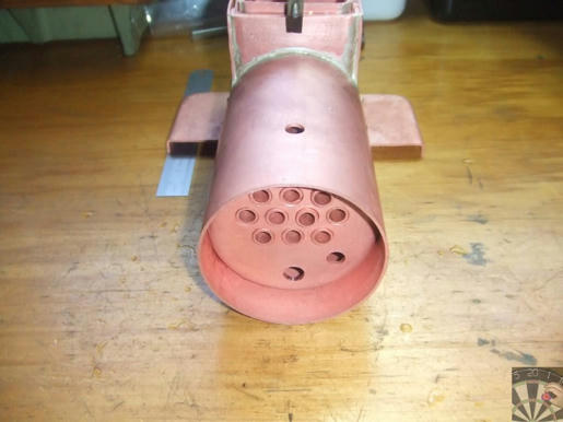

A bit of an update. The bushes are done so I gave the boiler a bit of a cleanup and had the smokebox in the sandblaster, to give it a zap and a coat of 650degC paint.
Just to make it look the part the safety valve, start of the regulator and inner steam dome are is with some of the plugs ready for the pressure test.

It's been a few weeks so a bit of an update on this. I got to the point of a preliminary pressure test, it was really a leak test, and I had a couple of small leaks and was in two minds how to deal with them.
My local ME supplier suggested I use Harris 'Bridgit' http://www.harrisproductsgroup.com/en/Products/Alloys/Soldering/Lead-Free-Solders/Bridgit.aspx to calk the leaks. I wasn't happy about this as one of the leaks was on the foundation ring so decide to use silver solder.
The upshot of this decision is that I've been going round in circles fixing leaks and creating more and getting more and more dejected as I went. What I thought was a reasonable first effort as a proper boiler is becoming a bit of a mess. I take heart from a statement in the Martin Harris Loco boilers book, along the lines of, "the best of us get leaks". At leats it hasn't fallen apart into a pile of bits, I did make it mechanically sound rather than rely on the solder to hold it together.
The lessons learned from this are I really got to know how my gas torch works and how to get the heat where I want it and next time I'll use stepped temp ranges on the silver solder.

Sorry about the tardy response but I think I've got it sorted now.
I chased all the leaks down by using low pressure air from a cycle pump, with the boiler under water, puncture repair style. This wasn't pressure testing it was leak tracking with no more than 20 psi. Once I got to the point where I had no bubbles I switched to the proper pressure testing procedure by filling the boiler with water. I took it to 120psi and held it there for long enough to be satisfied that it wasn't leaking and its ready to be taken to the club inspector for the formal inspection and test. We'll see how that goes. In the meantime I've been churning out various other parts. Pictures later

As for the boiler I took it to the club for pressure test. The inspector was happy with the construction but I had a couple of weeps that are best dealt with rather than hope they rectify themselves. To be frank I've got to choose the right time to attack it with the torch again. It will happen.
