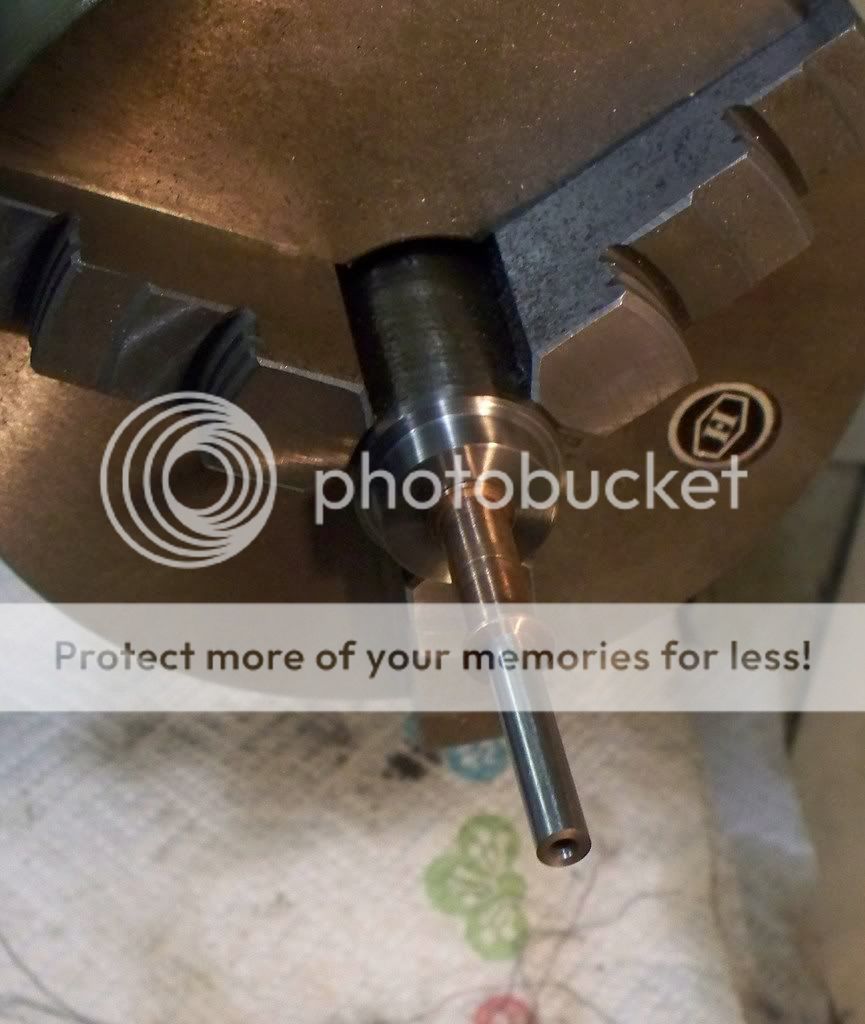

    Hello, thought I would share with you the progress of the model diesel engine I am building from the article and plans of Ron Chernich (Australia) he published in issue 1 of Model Engine Builder magazine. I started in January this year. My progress depends on the time I can get in the workshop and how fit I am (excuses I know!) The build is documented on my website (along with all the other projects I have done this year) http://www.mikes-models.com I hope the photo's load as this is my first time.....
    [​IMG]
    about to start turning the front taper.....
    [​IMG]
    Where I have got to at the moment........

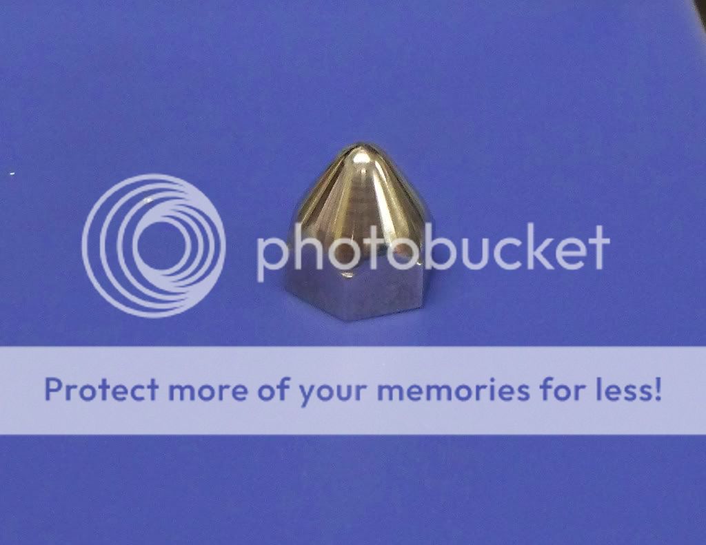

    [​IMG] the prop nut....
    [​IMG] why do we always trial fit to see what its going to look like when finished! (well at least I do......)

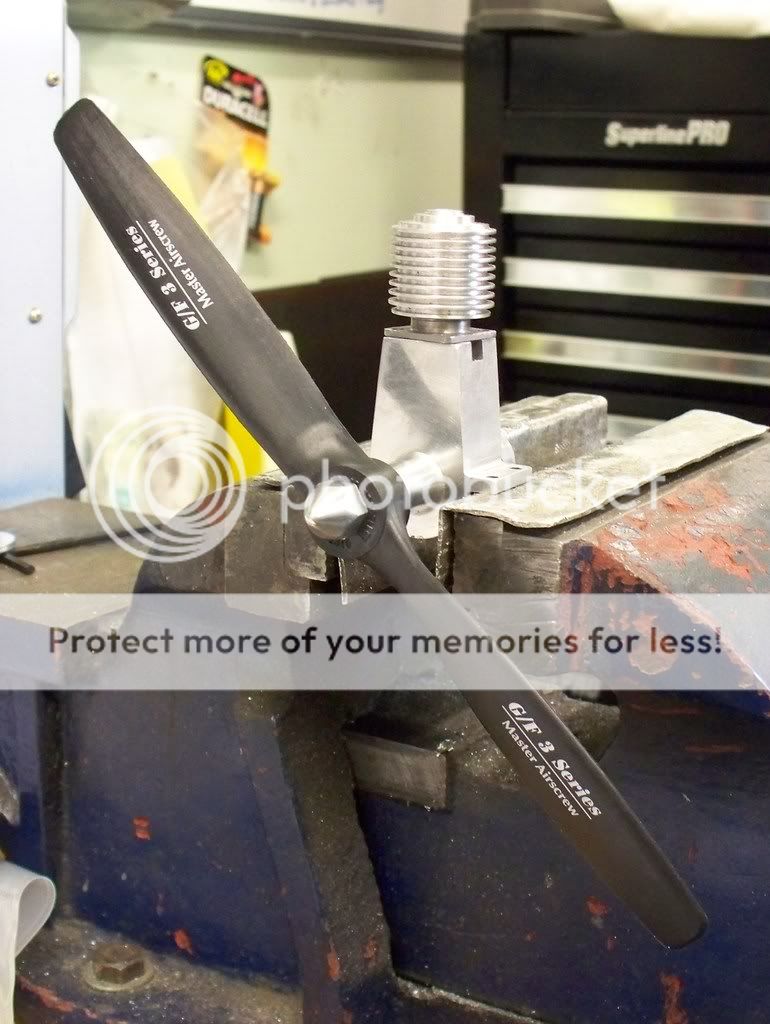

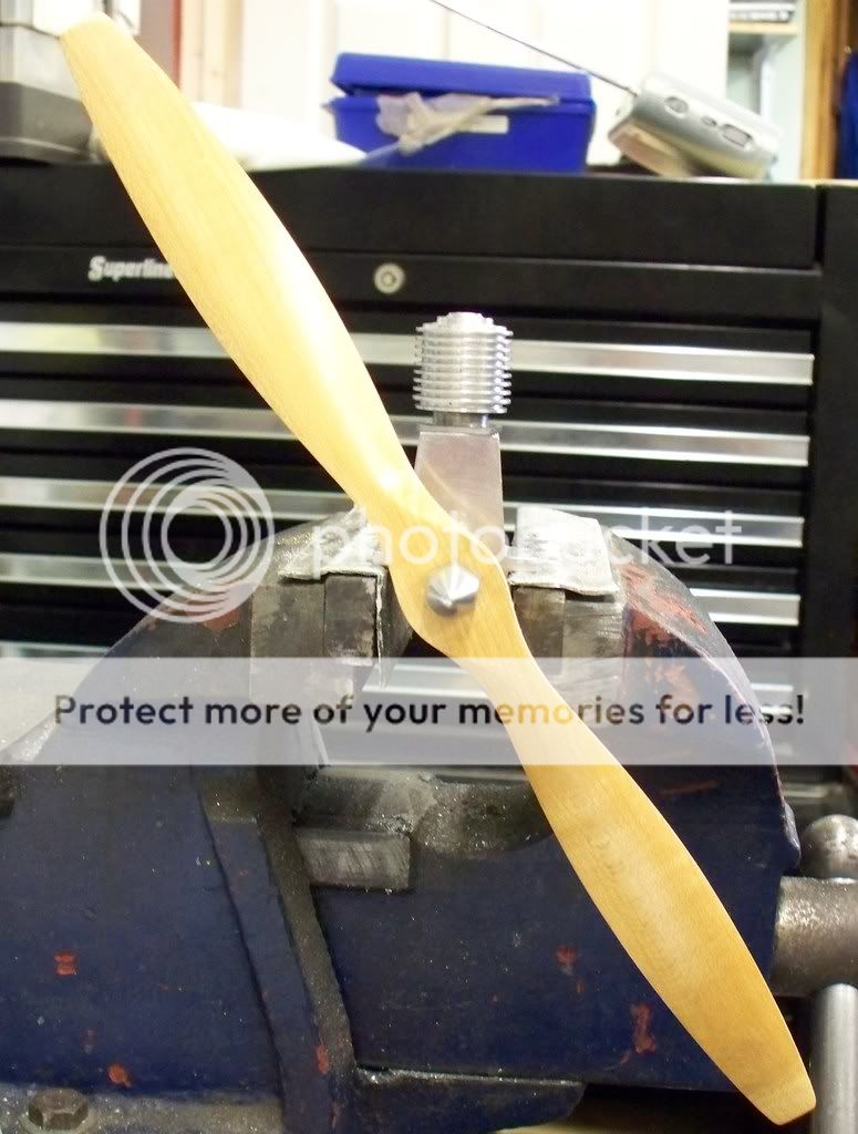

    Ron Chernich, the designer of this engine says it will swing a 12" wooden prop.......well it looks big to me!

    Thanks. I have been told these engines are very flexible and it will (not necessarily mine though!) drive a 12" wooden prop. Look forward to it breathing...........

    12"????????Wow,that's a BIG prop :big:
    Looks like a nice engine,Mike.I've owned a couple of diesels in my time(DC,Philtech),but could never get along with them.Please post a video of it running if you can,once you finish it.

    And I know it's only posed Mike,but PLEASE don't sha..... ruin such a beautiful engine by gripping and starting it in the vise, seen too many crankcases with knurl marks.
    Regards Ian

    Hello Circlip, caught you! The Mills is only sat on the vice and not held. But the comments you made are still of value. I am going to make a stand/clamp when I run it (as ever hopeful). Its the first time I have been well enough to get back out into the workshop today and only managed to make the compression screw and what a problem I had for a 'simple' job. I used a taper tap in the cylinder head to make sure it was a tight fit and used the die as open as it could be but the screw cut in BMS was not as tight as I would have liked. In the end I turned it from stainless steel on the hope that it was a harder metal. Fortunately it seemed to work, at least better than BMS.
