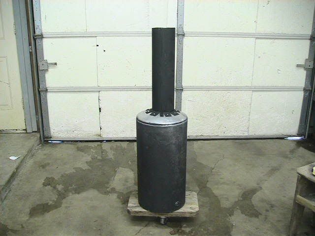

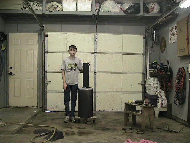

I have got alot done with the shell, heres what I did so far today.
Finished grinding welds off boiler
Painted it black
Ground off the bottom cap
Pressure washed the inside of the boiler, lots of oil and metal gunk

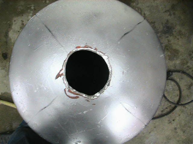

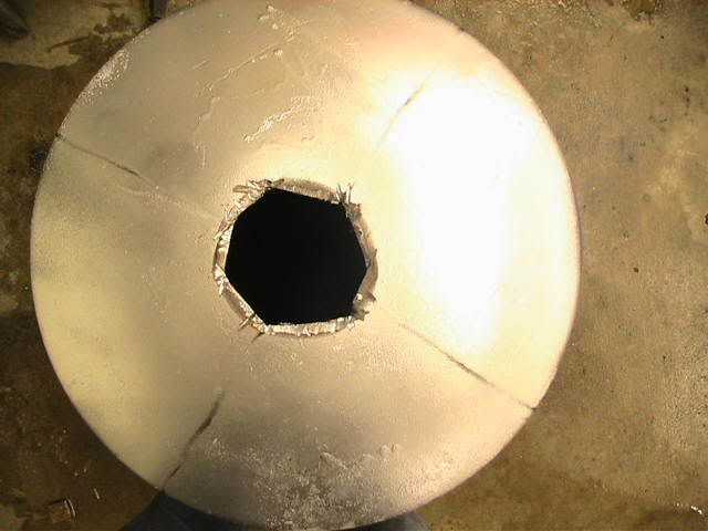

Cut a hole for the chimney, Rough at first.
Smoothed out the hole
Mounted chimney w/ screws,
Painted the chimney
Took it outside for a cleaning test. More on cleaning test after pics
Its ALOT brighter in real life than in the pics, but self adjusting camera doesnt do it any good.
Rough cut hole with a grinder.
Smoothed out hole with air dremel

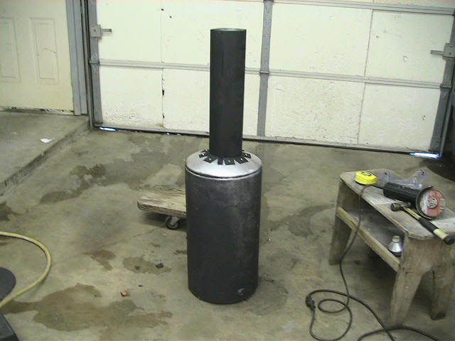

Simple metal drier pipe for chimney.
Put it on a rolling stand to take it outside, I'm lazy I dont want to carry it that far.
Me standing beside the boiler for size comparasion. I'm about 5' 5"

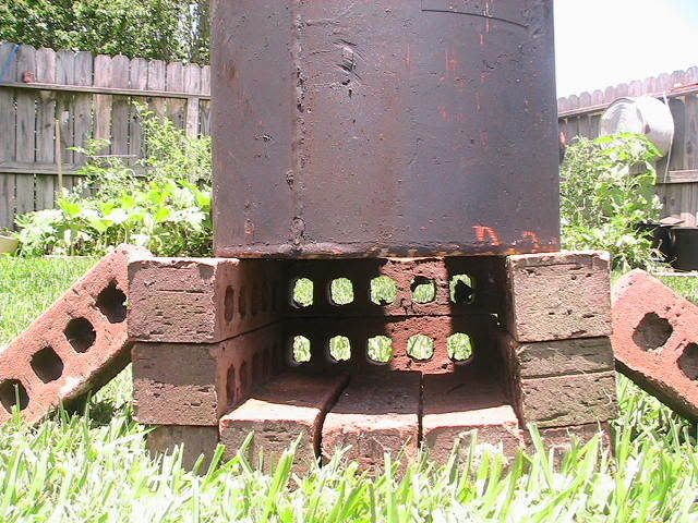

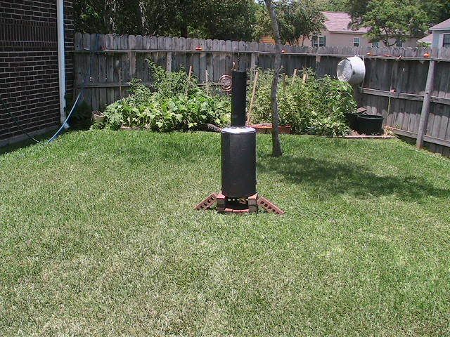

Took it outside and put it on a brick firebox

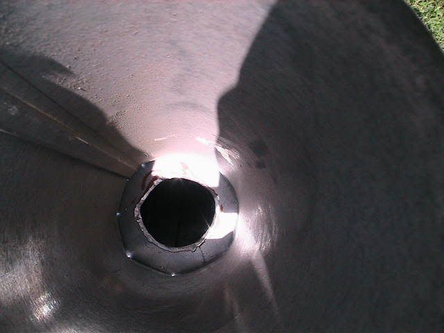

Looking down the chimney at the hole, I made the hole small so if I wanted I could make it bigger.
Thrown together brick firebox
I will get a fire going later. This is just the outer shell of the boiler, no copper tubing put in yet. I want to burn off all the oil and nasty crud that I didnt get with the pressure washer. Fire pics will be in a few hours,after it cools down a bit.

I lit a fire underneath the boiler to clean out the insides of the shell. This still doesnt have coper tubing in it yet, just cleaning the boiler, to get any rust or things like that off.
