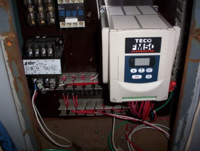

That's really an excellent write-up, summarizing the options available for a hobbyist. I converted my single-phase lathe to a 3-phase setup some time ago, utilizing the TECO FM50. I didn't find any aspect of it complicated, primarily because I closely followed the outstanding article on the subject, authored by John Pitkin. I have a large lathe than he does, but that wasn't really a factor in the conversion. If anyone's interested in his article, I'd be glad to email it if you'll provide me with an email address.
GBB,
Email sent. I'd like a copy of the article, please.
I have ordered an FM50, should arrive here Wednesday.
Thanks in advance.

Bernd, I have had my unit online for a little over a year without one glitch. To the best of my knowledge, these units are all electronic. If my unit failed, I believe I would simple replace it. For the cost of a new unit, I can't see a repair being cost effective.
I will add that the power quality here is terrible. We have spikes frequently, and have brown outs and black outs far to often. I have lost a computer, a router and phone system to the power issues, but the VFD just keeps going.

I had a FM50 VFD pop on me with only a few hours running time on it-- one of the big capacitors and who knows what else gave up the ghost.
I sent it back and it was replaced/repaired (I think replaced) after some wrangling (FactoryMation has a goofy defective-product return policy-- they don't pay shipping on defective returns either way, and just silently credit your account versus sending you a replacement)
I hate to hear that you had one fail. I have had very good success with mine. It has been reliable now for more than a year, and has never given an ounce of trouble. These things can and do fail, though. And there are a million reasons why. Yours might have been defective, it could have taken a power spike, a programming glitch, environment, etc... Who knows!!
If it is imperative that your machine is running, then I highly suggest having a spare unit on hand. As cheap as the FM-50 is, it is not out of the question to have a spare (though hobby budgets are tight and may not allow it). I have kept my static converter on hand for just that reason.

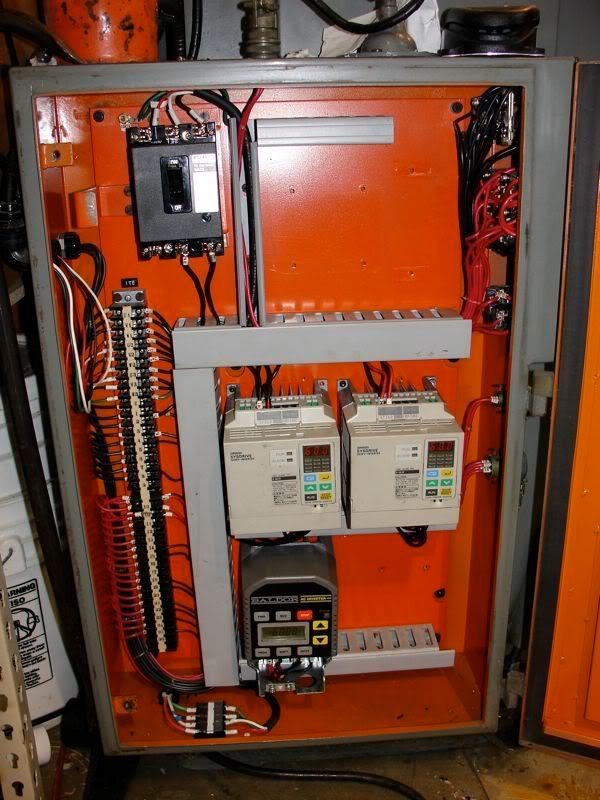

hello all I am using a teco freq drive model jnev-101-h1 on a bridgeport. This unit takes 110 and makes it 220 three phase and gives varable speed to boot and rev. Great little unit.
It cost about 390.00 but it is super eassy to wire a cave man can it :) and I have it about a year no problems and varible speed is a great feature.
