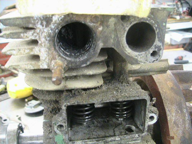

Well, I screwed up :mad: I broke a valve tappet on my 2 hp briggs. I'm not sure If I want to replace it but in the mean time I have this

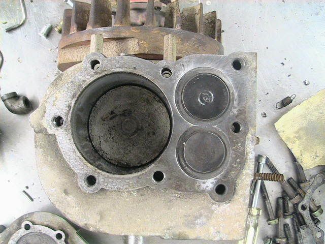

Its a 5 Hp Briggs & Straton gas engine, it came off an old generator that quit working. The problem was with the engine, the intake valve was stuck, I fixed that though.

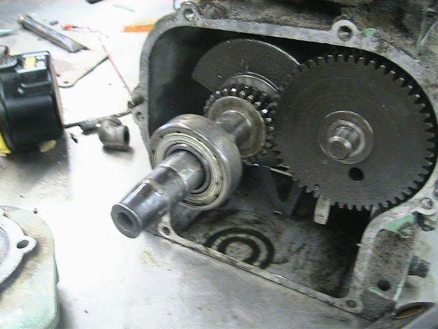

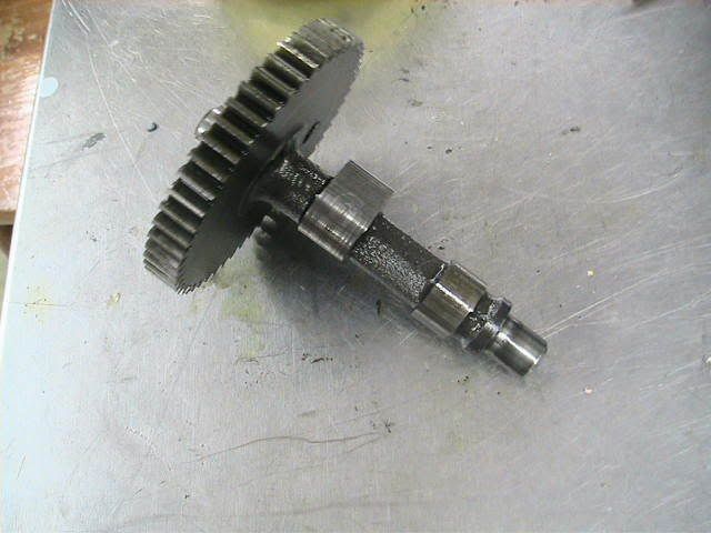

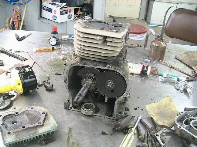

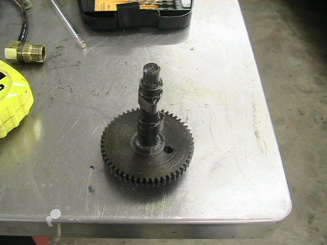

The the cam is already timed for 1 intake and 1 exhaust. A little fine tuning will help though, but now I have to add 2 additional lobes exactly opposite of the other 2 lobes. I would like someone to machine them, but will probably end up welding them.
Ok, the 2 lobes needed: Would anyone like to machine them for me? I will pay you of course, but I just need 2 little lobes machined so I can weld them to the cam.

You could build up the lobe with the welder then profile it with a file. Good learning experience.
Mostly you'll learn you don't want to file anything anymore. :D
Seriously though, filing it won't be that bad if you use a soft grade of metal to build up the lobe. And it'll make you a better welder. You don't want to add any more metal than you're willing to file off.
Looks like I'm going to weld the lobes on myself. I need to practice welding first, I have some round bar that I can make lobes on.
Hopefully I will get the intake lobe done today. Pictures will follow at the end of the day.
I welded the lobes on Thrusday. I used a little lincoln MIG welder, after careful grinding and trial and error, it works.

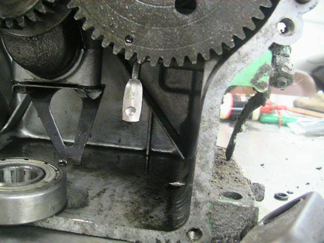

Here are some pice of the camshaft, it looks sloppy but it works great
This type of thing is easy to do to almost any 4 stroke gas engine.
