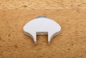

Now we get to the real meat of this task. How do I hold those rounded parts so that I can cut out the rectangular relief that's under the mounting screw? I want something with a concave radius that matches the convex parts, to hold it upside down in the vise. I thought about using the rest of the steel that I cut them out of, but that's the wrong radius. That radius is 3/8" more than the part because of the cutter going around them cutting out the parts. At some point, it occurred to me to use my 3D printer to print a fixture. An hour and 30 cents worth of filament later I had a fixture.
The two parts squeezed together are .620 thick, and I made the plastic thinner - like about .575 - so that the jaws wouldn't just squeeze the plastic but would lock the parts in place. I made sure the bottoms of the blanks were parallel to the mill table with an angle gauge.
Once I cut the rectangular cutout, the printed fixture was a perfect way to hold the two parts to drill the through hole. Being backed by plastic and not my vise made it risk free to the vise so a no-brainer to do. They're not technically done in this picture, there was one more step, but they're pretty close to being done.

First, I tried to turn between centers without a dog to see if it could work but I could barely scrape anything off the piece. After looking for options, I thought I could make one out of a 2" diameter piece of steel or aluminum, about an inch long. Bore a 1.5" diameter hole in the middle. Cut away everything that doesn't look like a lathe dog. My immediate problem was that while I had a cutoff piece of 2" aluminum, it wasn't long enough and I had no other junk stock big enough to work on. I eventually found a piece of pipe in my junk stock that was smaller than 2" diameter but big enough to work, so today I made it into the lathe dog. It's some sort of soft, gummy aluminum alloy, maybe the stuff they make shower curtains out of.
It isn't strong enough, probably because the walls are too thin. When I tighten the setscrew more, the ring stretches. I made some test cuts with it and it seemed to worked well enough, though. If I had some steel or something that would resist stresses more than this one, I'd make a replacement.
I'll go ahead and try it, though. Within a few days, I'll know if it holds up to the stresses of making this crankshaft.
