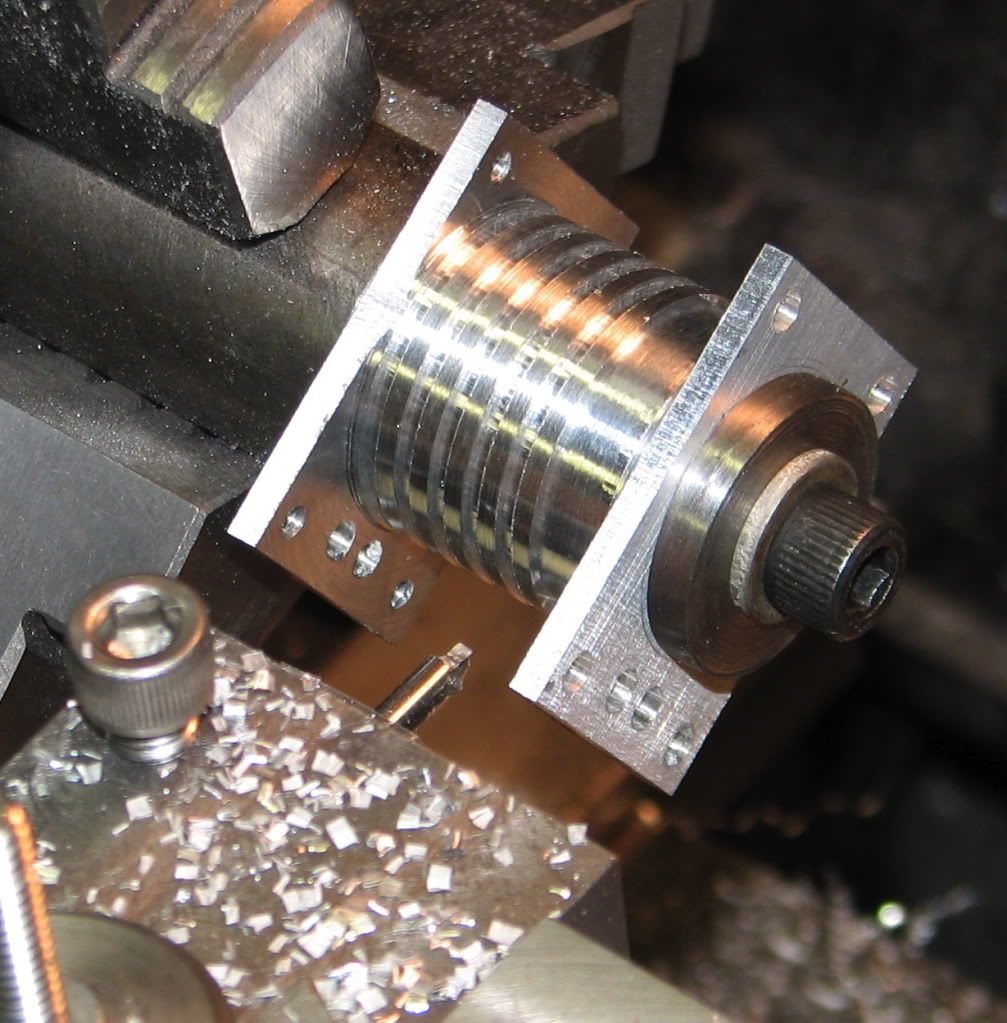

I got a bit more done on the engine this week. I started on the cylinders. The smallest stock I had that could be used for the cylinders was 2 inch round rod. A bit large but it will work. I started by cutting 3 pieces about 1.25 inches long and then mad lots of chips. I milled the 1 and 1-3/8 dimensions about .025" over sized. This way if I am a little off on the bore it will be OK.
After drilling the center of the bore with the DRO on the mill I went to the lathe and drilled .625" diameter and bored to .750 inches.
Next I modified the arbor that I made for the bearing housing. I turned it to a close fit on the cylinder bores with a length of approximately 1 inch. I made a slight undercut so that the inside radius does not cause any problem. The thick washer was unchanged.
After a detour to make a better parting tool holder I turned down the 1 inch diameter. I will not be making the simulated fins since I do not ave a suitable tool.

I made the tool to cut the fins from a small bit of HSS they only need to be a scratch deep, Another good source for thin grooving tools are broken hacksaw blades with a suitable holder.
Stew
This weeks update on the build progress.

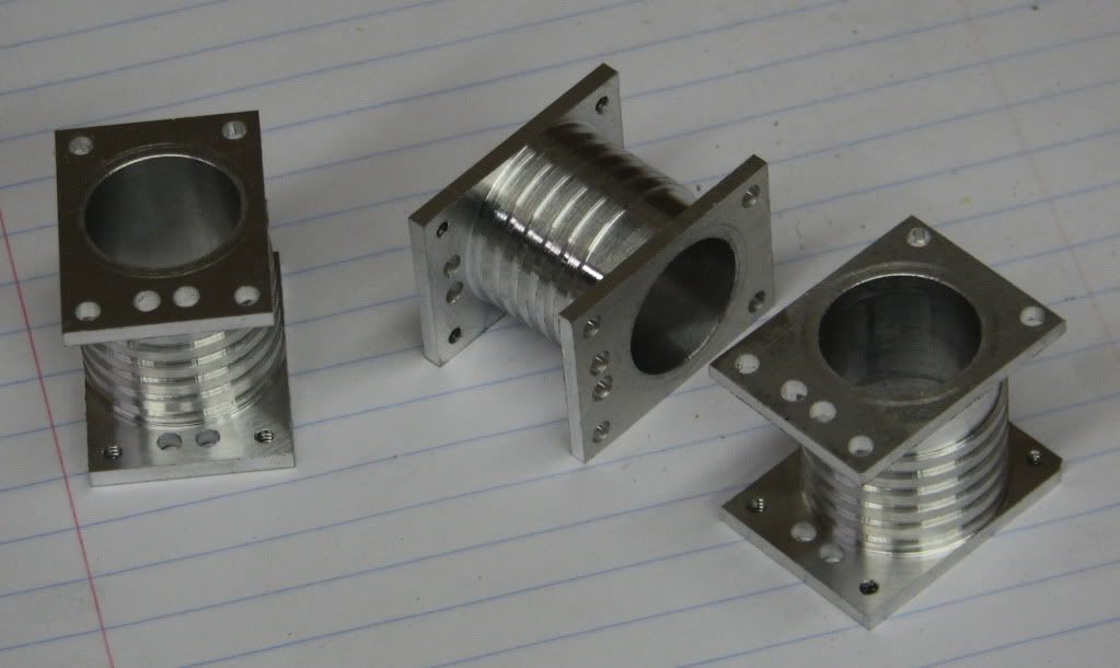

I had limited shop time this week but did get to nearly finish the cylinders. Based on Stews comments, Thanks Stew, I made up a tool to cut the fines. I used a .125" diameter center drill that the tips had been broken off to grind a .060" wide tool. I made a simple holder from a 1/2" square piece of steel to told the tool and used it to cut the fins as shown below.The other end of the center drill was ground to use to face the inside of the flanges.
I still need to round the corners of the flanges but that will wait until I have the cylinder heads finished so that they can be done together. Here are the nearly finished cylinders.

First the cylinders. First I cut the six 1/8" brass air tubes just a few thou less than the height of the cylinders. I did not want them proud of the cylinder ends when assembled. I held the tubes in place using Loctite 609 retaining compound. After a 24 hour cure I installed the cylinder liners using the same retaining compound. Again I waited 24 hours for the compound to cure. The final operation on the cylinders was to mill the air passage at the top of the cylinders between the air tubes and the bore as shown below.
Here are the finished cylinders
