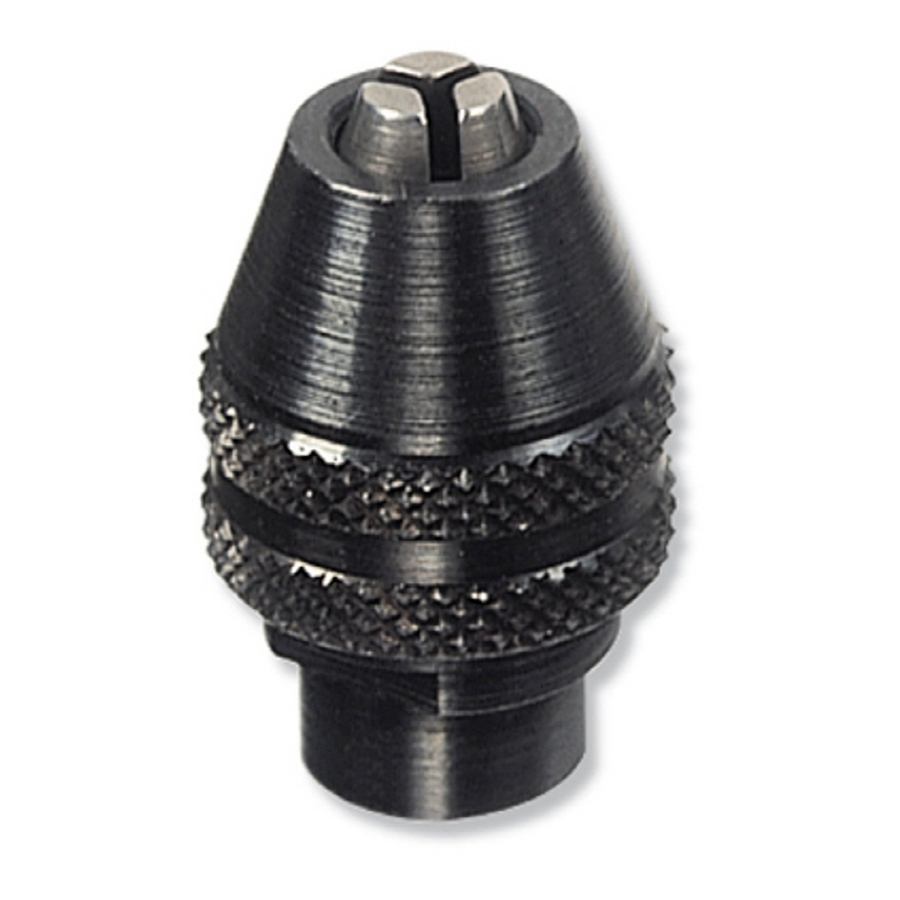

As far as a chuck goes, you need precision. Dremel collets, and their little chuck work good, up to 1/8 inch.
I just picked up a couple of these . They are German made I believe by Bosch
Dremel
Model: 4486-03
1/32" Multi-Pro Tool Chuck
Lowes Item #: 107391 I actually got them at home depot
these use a dremel thread see here for more info
http://www.homemodelenginemachinist....cseen#msg50468
