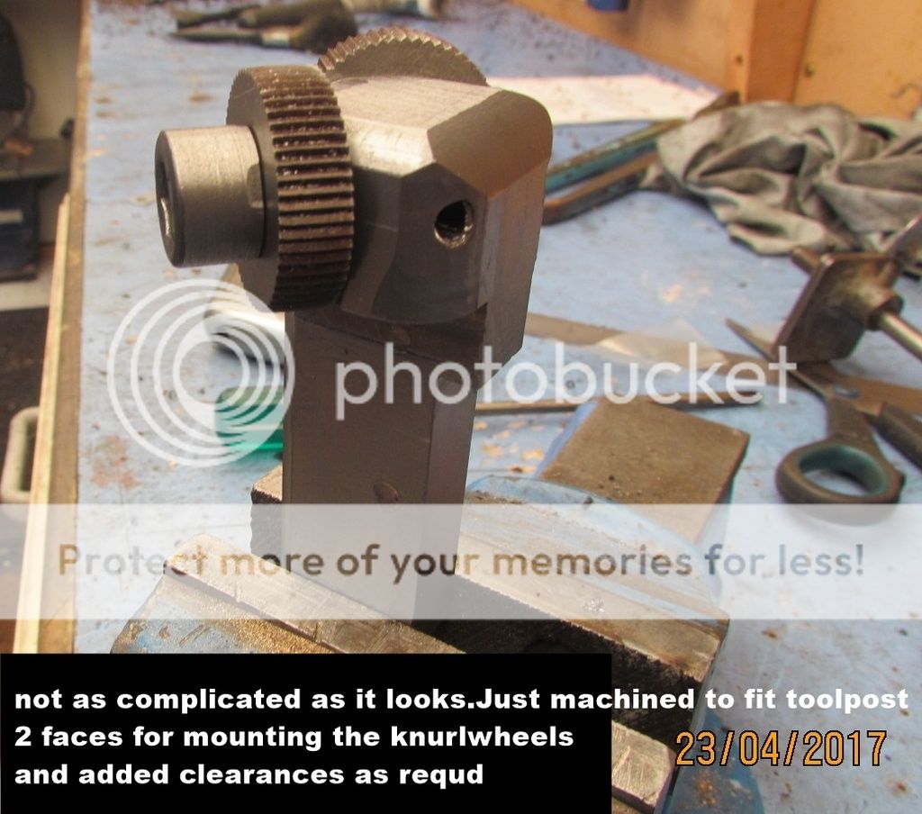

Default Making a cut knurling tool

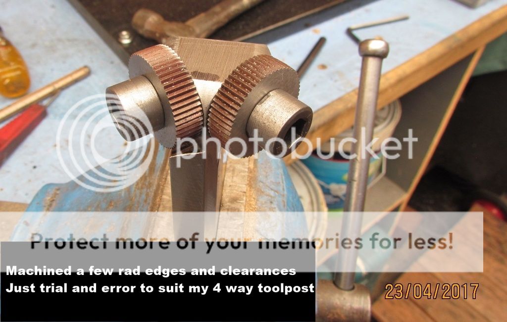

I did my first knurling at school,and then some more during my apprenticeship
Never very successful,but crush knurling never is,so turned my thoughts to
cut knurling .Various homemade tools on Utube,cheap and simple and some
VERY expensive commercial units.With the little information available and a
few thoughts in my head I decided to make one.So cheap and simple I did not
think it would work,so decided to fab a cheap bodgeup to see if the basic
principles work.BOY DO THEY WORK,simple,cheap and almost professional quality at the 2nd attempt.I bought a single cheap straight knurler Ebay
simply because it also came with 3 pairs wheels and one fitted.I welded
a small piece of angle iron to a piece of flat,drilled and tapped and machined
2 no m10 cap screws to m6 shoulder bolts the packed and shimmed to centre height.Using a piece of 30mm dia steel,much tougher than mild steel I had a couple of practice runs and got a good knurl at 1 pass at 30 thou deep
Photos tell the story.Will play about a bit more before taking it to the next level
by maching a solid housing/tool to a much more acceptable standard.This is great,i have taken a video and will post when I have uploaded.WATCH THIS SPACE this has great potential.Best knurl I have ever done

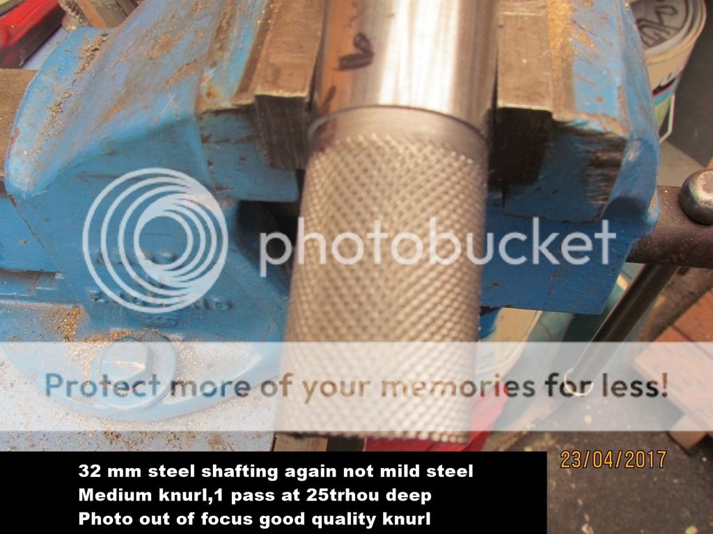

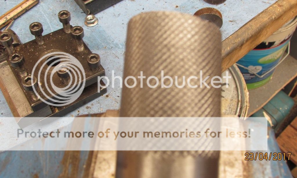

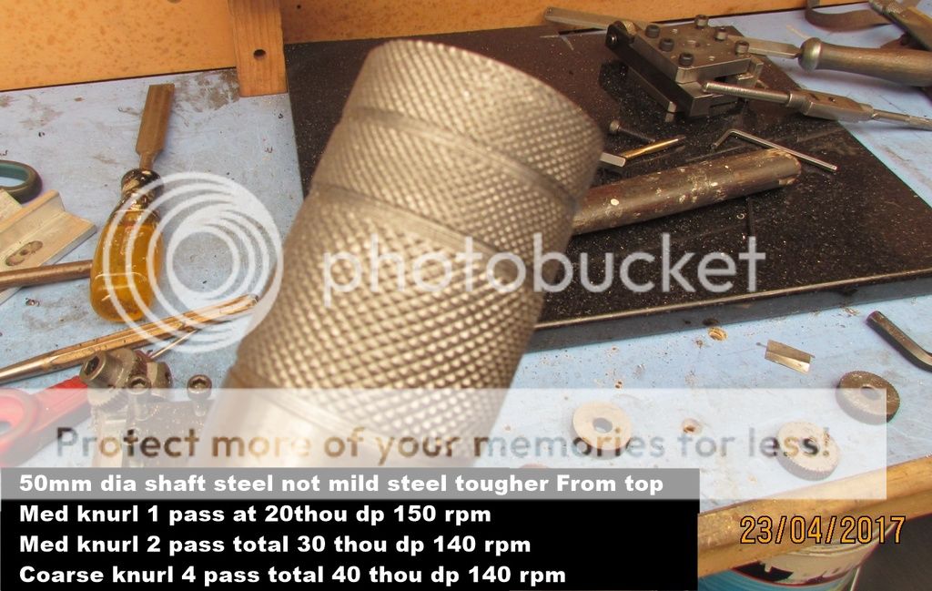

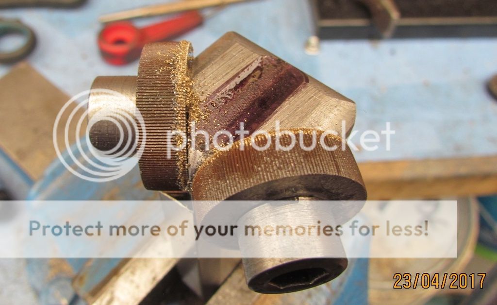

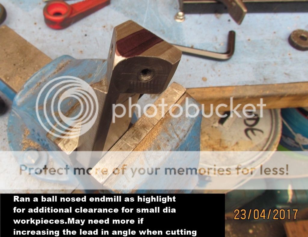

Default Making mark 2 cut knurler

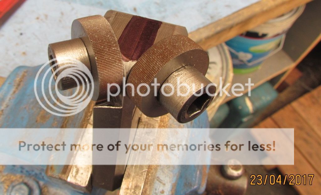

Started with a piece of 32mm sq x 80mm lg hot rolled mild steel
Cleaned up all around,machined to fit my std 4 way tool post
and machined the 2 knurlwheel faces at 40o rather than 45o
to try achieve more of a diamond pattern.Cant seem to notice any difference
and the orig at 45o seemed to cut better.Tested various materials from
1/2"brass,16mm dia mild steel,32 mm alum to 50mm dia tough steel shafting

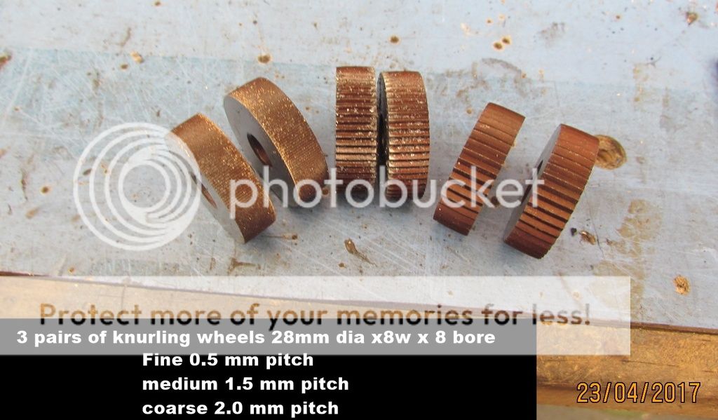

with varios feeds,speeds and depth of cut.In general I would note the following-
the fine knurls 0.5p are only good for small dias.Good results on brass ,alum.
The medium knurls were best for all round use but the coarse knurls were OK forlarger diameters and aluminium.Lathe speeds were in general between
100 and 250 rpm. Fine feeds were used throughout but hand feed was ok for light cuts.
In general knurl depth was 25 to 35 thou dependant on matl,diameter and knurl pitch and took a full depth of cut on steel of 30 thou as well as up to
4 passes at 10 thou each to total depth of 40 thou.Multiple passes were easier
on the tool and lathe and each pass picked up with the previose with overriding on the cut knurl.AT THIS STAGE I AM VERY PLEASED WITH THE RESULTS and would recommend it to anybody over the scissor crush knurlers
Conclusion.The tool is easy to set up but must be on centre height,although I
machined to size and shimmed slightly just touching the workpiece until both wheels revolve confirms height.However a QCTP would be ideal for ease of setting,and if going that way then rather than make a tool to mount in the toolpost I would look at making a dedicated toolholder with the wheels mounted on to just slot into the QCTP. This is the way I will be going next
Keep this thread open
