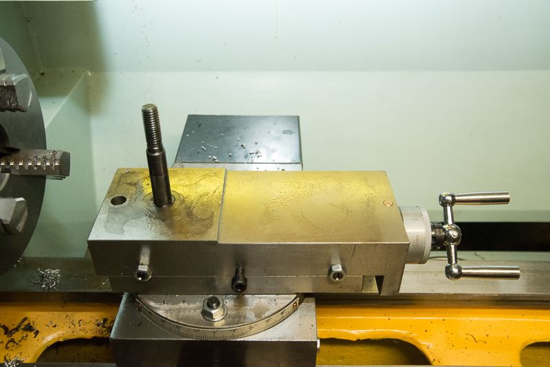

Originally Posted by rodw View Post
Sound like the one they recommend. I think because the lathe is sold as being for 12mm tooling. I've kept with 12mm as I had it for my last lathe. I have a couple of 16mm tools and they work fine on this toolpost. I thought I might need to machine something off the bottom of the holders but so far so good!
The massive 25mm boring bar I got from CTC that fits the BXA holder is absolutely awesome! SO rigid!
I rarely turn my toolpost but it is handy to have the spanner there. I used to do it a fair bit to chamfer after facing but now I use a 45 degree neutral tool. Sometimes I remove it if its in the way as the bolt holding it on is only finger tight. I usually align it using a small set square against the back face.
Hi Rod,
I get the 320 delivered next week. I was waiting for the H&F sales.
I have purchased the bolt for the QCTP. However, I would like to know what length of shank you ended up with. I was wondering if I need extra length on the 10 mm tap to be able to reach far enough. I haven't got the lathe here at the moment so I am not able to check it.

John, I just measured things for you. The 16mm shank is about 94.5mm long. The large hole in the bolt is 48mm long and the stud on the 320 is 69mm long and the M10 thread is 29mm long.
An ordinary M10 tap is about 70mm long to the square shank. So a bottoming tap will cut a thread long enough if you screw it in as far as you can so the square shank is part way in the hole. I had a long shank drill bit and i drilled the bolt M10 right through but it was not necessary to go right through. An ordinary drill bit will drill far enough from the head end to meet the larger hole.

Hi Rod,
That's great, thanks for going to that trouble for me.
I have ordered some 10 mm taps from CTC Tools and I have already got the bolt. I am hoping to get the lathe delivered on Thursday. I will start the modification to QCTP as soon as I receive the taps. I will let you know when I have finished.

Hi Rod,
I finally got the lathe up and running. I made the QCTP chicago bolt today and it turned out great.
Thanks for your help and posting your experience. Simple to make and does the job perfect.
You guys must get sick of seeing these sort of posts, but here is another one!
Hare & Forbes wanted AUD $500 for a QCTP (I think it is a Dickson Style). The salesman reckons no one bothers to buy it as it is a major job to fit it to the AL320G that has a tool post like this:
Hi Rod,
I have the same lathe and want to do this to mine as well but its different than yours ? Here are some pictures of it but I don't know if the QCTP will fit as it has a shoulder attached to the top of the X/slide where the QCTP would go ? Dose that QCTP of yours have a hole in the bottom of it that would fit over this shoulder thing ?
IMG_20150501_115913_703[1].jpg   IMG_20150501_115948_822[1].jpg   IMG_20150501_120001_279[1].jpg   IMG_20150501_120017_161[1].jpg
timoxx4 is offline
Old 05-01-2015, 10:26 PM   #40
rodw
Join Date: Dec 2012
Posts: 1,047
Liked 311 Times on 242 Posts
Likes Given: 161
Default
What is the diameter of the boss? If it is 16mm or less, the QCTP will fit over it, if not, it looks like you have an exercise with a 4 jaw chuck to bore the recess in the QCTP holder. From what I've heard, they are hardened on the outside but once you get through that, they'll machine OK.
