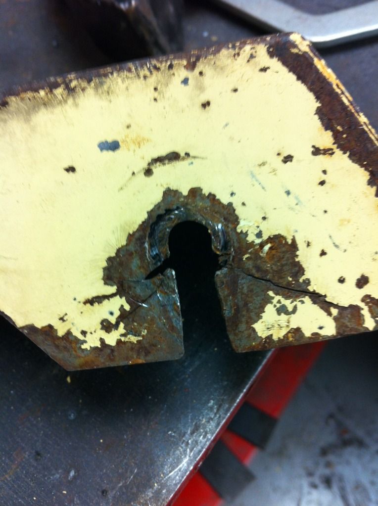

Then there was the fatigue cracks and frame damage.
Shown here was one of the patches to save a chain guard. I would weld it in and then trim to fit. It went on and on. The decks were badly damaged with the chutes hanging bend and distorted. One was hanging by a thread. Piece by piece we repaired the best of the parts.

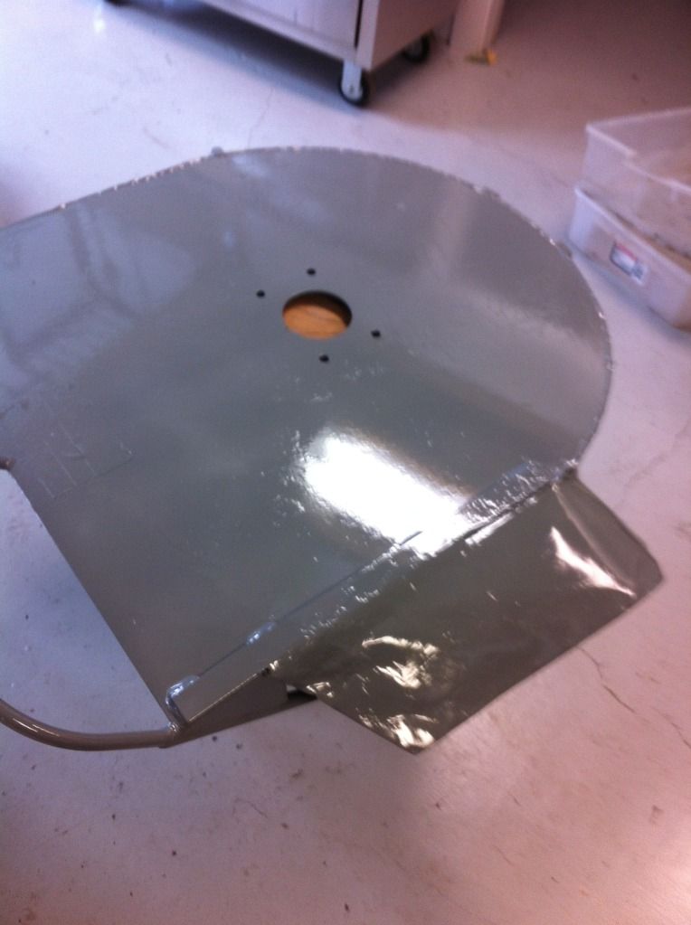

Then there was the tedious job of removing the old rust and paint ready to prime. I know we didn't have to go this far. I guess it was a matter of pride.
Everything got a coat of epoxy primer.

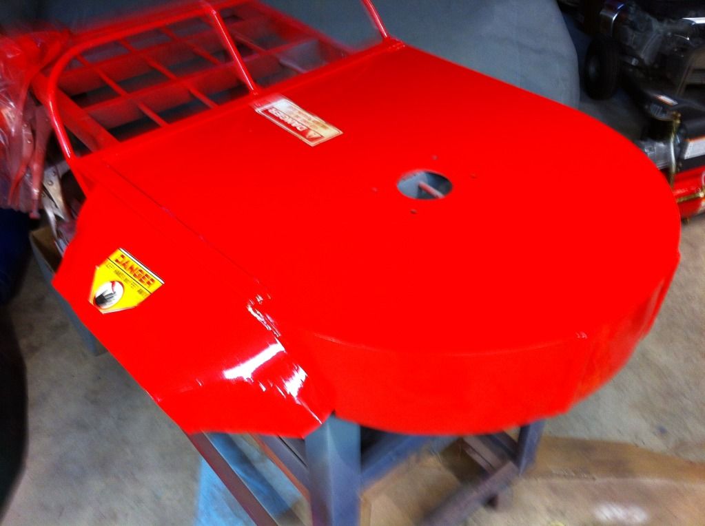

And everything was spray painted with either acrylic enamel or two part urethane. Noticed I masked off the caution and warning signs.
Here they are finished and delivered into service. I was glad to get them out of my shop. Lynn and I put in 82 total hours on these and $360 for the pair including bearings, shafts, and paint. It was hard to know where to stop. We wanted to make them look nice without getting carried away and hopefully operators will take a little more pride.
