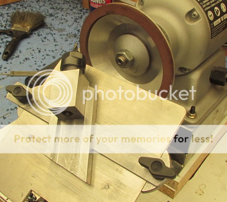

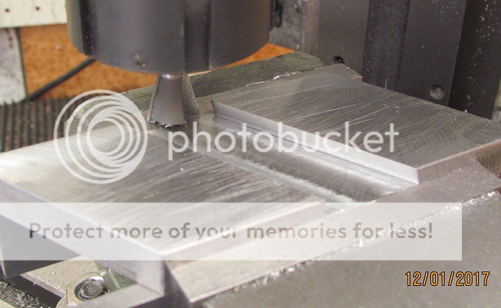

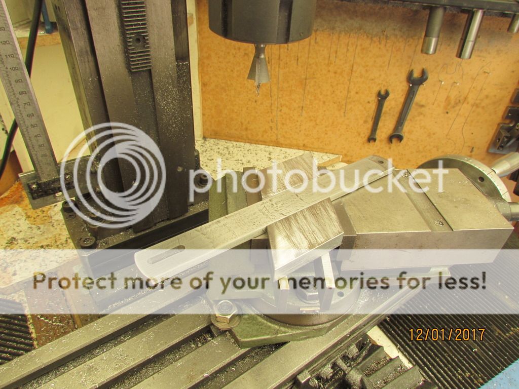

A little progress.Started making a dedicated fixture for twist drills
I like the dovetail slide rail so working from that I made a dovetail
slide block dedicated at 118o.I machine the er16 collet block down from 40mm sq to 30mm sq and milled a slot to accept it.Now to tidy a few loose ends
and work out an adjustable stop etc.It has become more stable now the tool height has been reduced
bazmak is offline

https://youtu.be/5U9UBxjLpMo
The collet and block works well,HOWEVER after all the years when items can be LH or RH how
many times have we made them the wrong way. 50/50 I agree but its like the jam side of your
toast falling face down.I thought about lh and rh before starting the holder,decided it didn't apply
And carried on.Wrong.Thought I could solve it by changing the wheels around on the grinder and
turning the grinder around.OK till I started to sharpen a drill and realised the table would have to be
tilted up and you cant see the cutting edge.So when the hot weather has eased off and I get my
head into gear I will make another with a few changes to improve the existing.The brass stop is fitted at the front
but I would prefer it at the rear etc etc

Hi Baron,i assume from your photo that the whole table slides side to side
on the grooved nylon wheels.I have also ordered an er 16 collet chuck
on a 16mm dia spindle which could slide in a housing rather than a collet block
and take me in the same direction as you.With regards to my problem I
have tried grinding with the table tilted up and I am not happy with it
I will make a new slide and beef it up slightly so I can fit a feed screw
alongside with the stop at the front and the knurled feedscrew to the rear
I am only playing about and that's half the fun for me.But looking at your photo
another avenue will be a sq block reamed 16dia and my new clollet chuck fitted
the fine adjustment can then be fitted to the 16 dia spindle.I would have
to fit a keyway to spindle to give a sliding fit and stop it revolving
