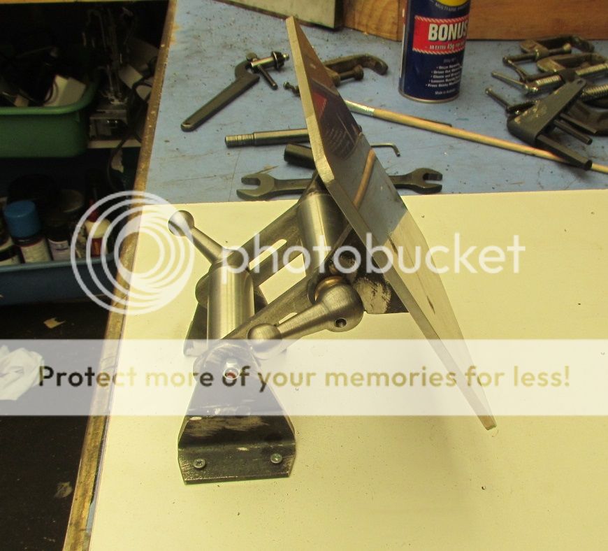

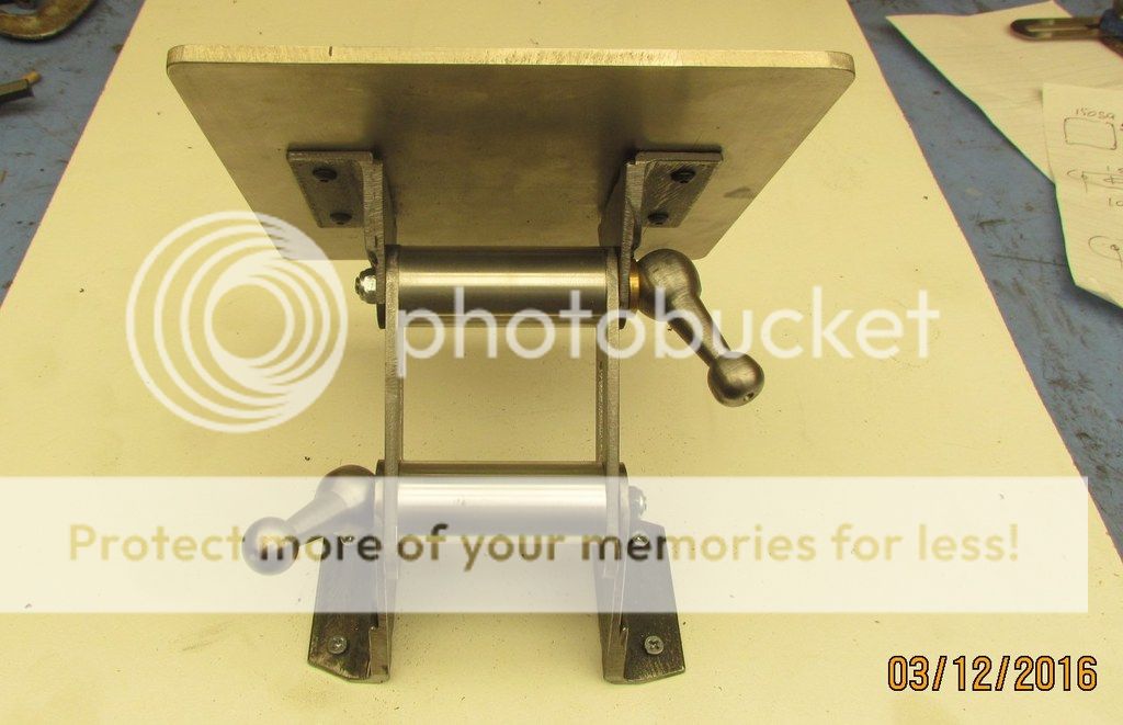

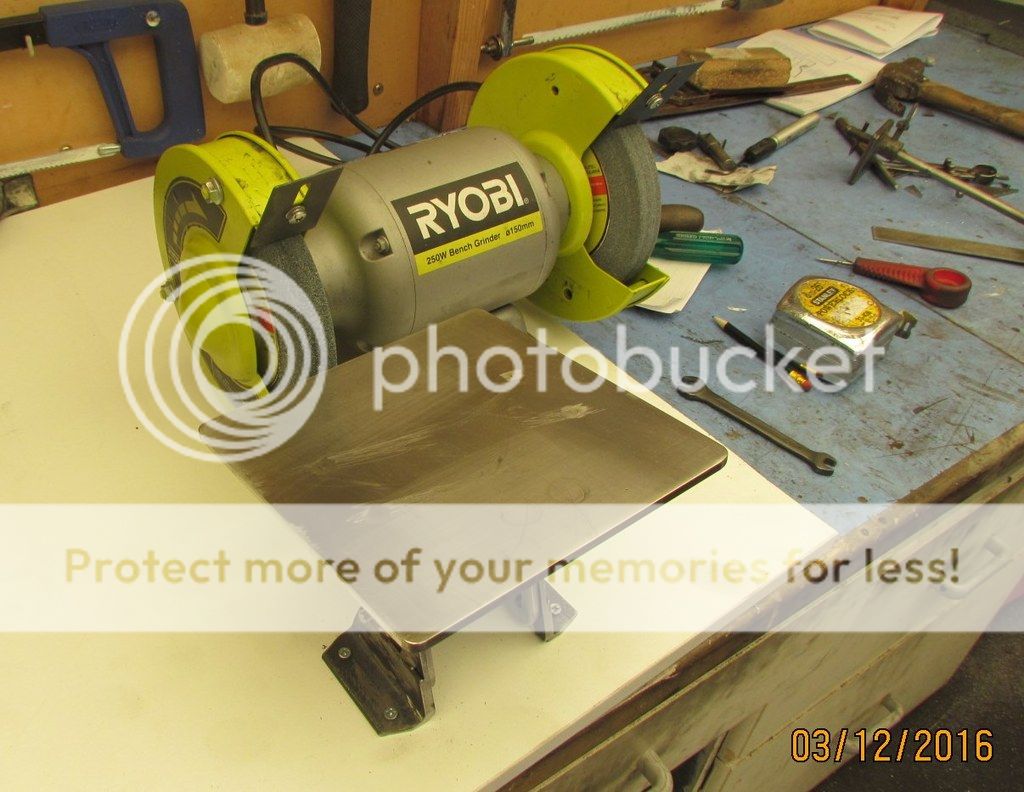

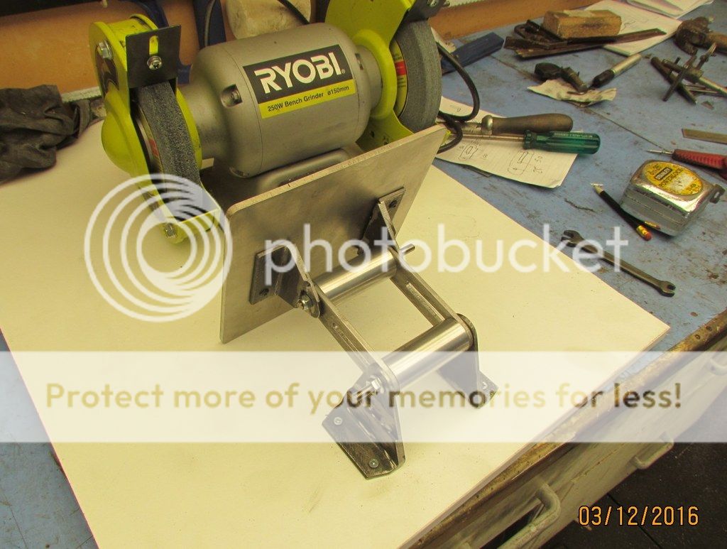

Just started my next project.I like the look of the acute system and with
information gleaned from Utube etc have sufficient info to make my version
However to play fair with Eccentric Engineering I have bought a set of drgs
for $35.Have made a start with the table as drgs have not yet arrived
Table calls for 150mm sq x 4mm m/s so I used 165mm sq x 5 thk S/S
4 brkts were fabbed from 25x3 angle and 3mm plt,Spacers 25dia alum
M6 allthread S/S screws and although I have ordered a few knobs and clamps
from China I also made 2 ms lever arm screws.Table works well.Now waiting for the drgs before deciding how far to go with the pantograph arm etc and what
changes if any to make.As usual flying by the seat of my pants

Weekend is here so hopefully the drgs will arrive tomorrow.Meanwhile I have ordered a 150d x 25w lapidary wheel 240g from china and will also order a 150dia cup wheel say 180g and try to setup both sides of the grinder
I want to set up to simply sharpen drills single facet small sizes I have an er 32 collet set which I can try but I think will be too large so I have in mind to buy
an er16/20 collet set and make a square holder.I think this is a useful thread
for both old (very skilled engs) and young newbies.I think I am in the middle somewhere.Most of us are still learning so please input anything of interest

Drawings not yet arrived .Dont know exactly where I'm going yet its all
in my head.I plan to make the pantograph arm and guide rail so will look at
a tool holder to fit the rail.Will try and fit my er32 collet block even though I feel it may be too large.The block is 40mm sq and the nut 50mm dia so I machined a piece of angle to a nice sliding fit for the block and raised 5mm to clear the nut.I then made a shaped end plate drilled and tapped ME
5.5mm x 40 tpi.Made and fitted a brass adjusting screw but this was too slack so added a m3 grub screw with a nylon plug to tension the screw Looks and works well.Next step is to make a swivel plate to fit the intended guide rail
and mount the holder.Will have to wait and see its all in my head
