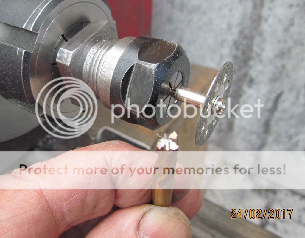

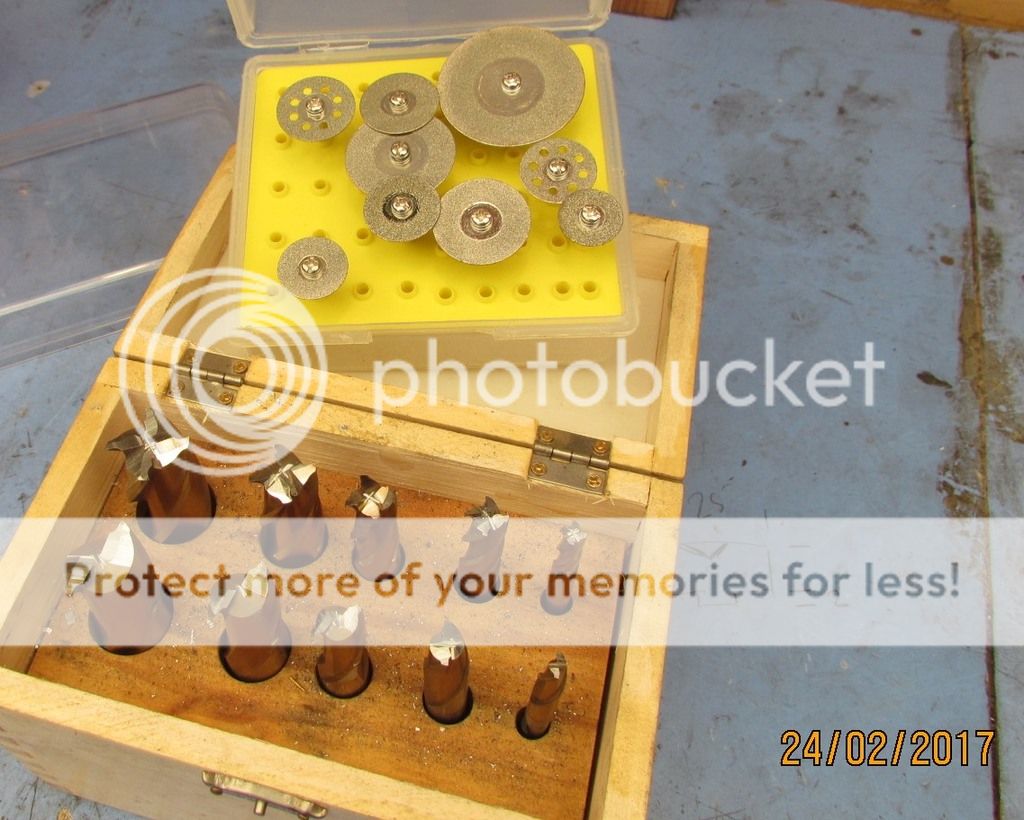

Default Final chapter on this thread
When I first bought the mill I bought a cheap boxed set of HSS end mill
containing 5 each of 2 and 4 flute end mills.With little use on mild steel
they quickly lost there edge or chipped.They worked well in alum,brass and CI
so I kept them in reserve and when cutting mild steel I used carbide to rough out with a light final cut to square out the corners.This exercise is to try and refurb as many as I can
I bought a cheap set of small diamond Dremel style wheels and set up in the lathe to grind the centre relief by hand and eye.Works well on the small end mills but too thin for the larger ones
Using the eccentric and my systems I proceeded to grind all sizes.Partial success.The 6mm 4 flute were unsuccessful due to my poor eyesight and the fact that they were well worn.The 2 flute was partial successful
It became easier as the endmill size increased.Where possible I will now buy
larger 2 flute carbide slotcutters/endmills and accept the 6mm and smaller as throwaway.I will limit the use of larger HSS for special occations etc and use mainly 2 flute.The eccentric system is now finished and works OK with a couple of extra tool holders to be made as required
