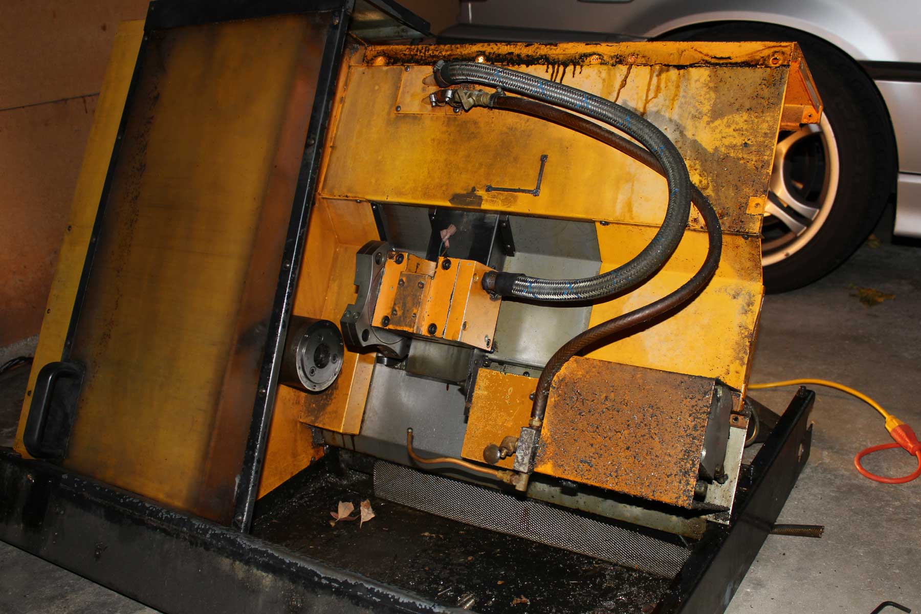

I had been looking for one of these small Emco machines for a few months. They aren't too common, but turn up here and there. I was lucky enough to find one close to home last week on craigslist. The price was right and it didn't have a control which was perfect. After digging into it it looks like it had a fairly rough life. I am going to have to come up with a chuck for it. I was told it had some kind of manual collet chuck being activated by an air cylinder. The motor is a 380VDC shunt type, 6000RPM max. I'll have to replace it with an AC motor and VFD I still have to figure out if it's OK to run a 3600RPM motor at 6000RPM by increasing the frequency. I was fairly set on servo motors with Gecko drives, but am reconsidering. There are 5phase steppers in the machine and 5 phase drivers can be found. The biggest problem with this project will be getting the turret working. I'll be using EMC for control.

Progress has been slow with this. I did find an IEC100 frame induction motor and with help from Ken I, decided that would be the best way to go. I already had a open loop vector drive that I just pulled from my manual lathe after finding a $45 AB Poweflex 4 drive for it. I decided not to use the steppers, and have some dc servo motors on the way. Finding chucks for this machine has proven to be difficult. I'll probably end up with a 4" Bison 5C chuck initially.
Virtually everything is off the machine now. This machine is a mess, covered in grime and chips. It came out of a shop not school like most of these. Documentation I found online appears to say that the ballscrews are preloaded, but I haven't looked closely at their condition yet.

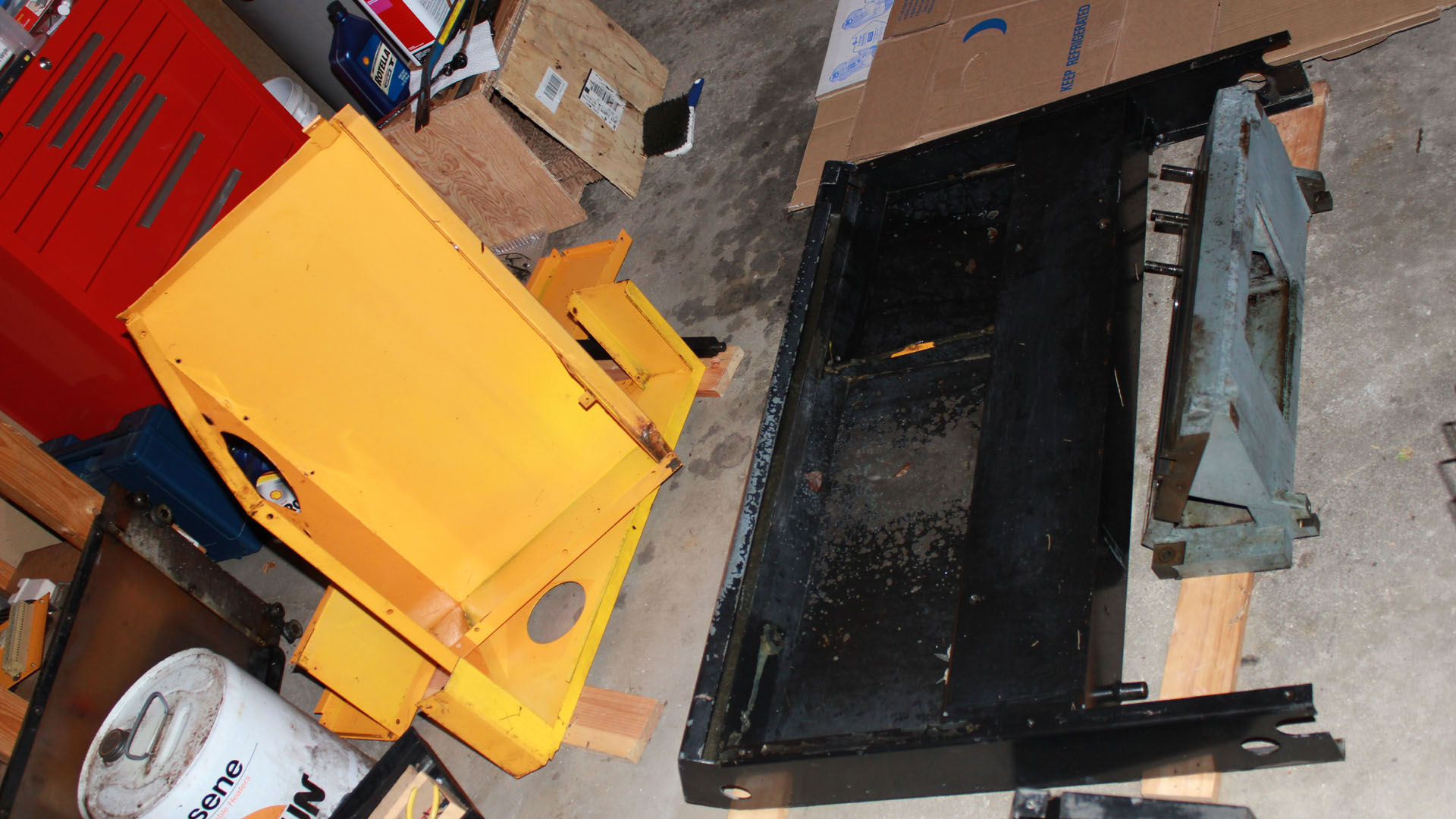

We had a very mild winter day so I gathered the parts and hauled them over to my parent's house to pressure wash. The sludge stuck on this machine was tenuous. The detergent for the power washer didn't even touch it. I'm sure the balmy 39°F temperature didn't help. I ended up using a spray bottle and a half of Zep heavy duty citrus degreaser and scrubbing with a brush, all parts at least twice, blasting away the grime with the pressure washer in between. Now, I have some mostly clean parts sitting in the garage. I wiped the ways of the bed casting dry and sprayed them with Corrosion-X.
All of the screws I took out are covered in the same slime. Normally, I put them in the ultrasonic cleaner which does wonders for screws and hardware. However, the detergent I use in it did have much effect on some parts I already tried washing. I'll have to soak them in the degreaser first.
Tomorrow, I hope I get a chance to get over to the hardware store and pick up some lumber to put together a base for the machine. Then we'll have some pictures of the rebuild. I have a new spindle motor and drive, axis servos, gecko drives, Mesa Cards. I think I'm ready to go except for small stuff like limit switches and wiring.
