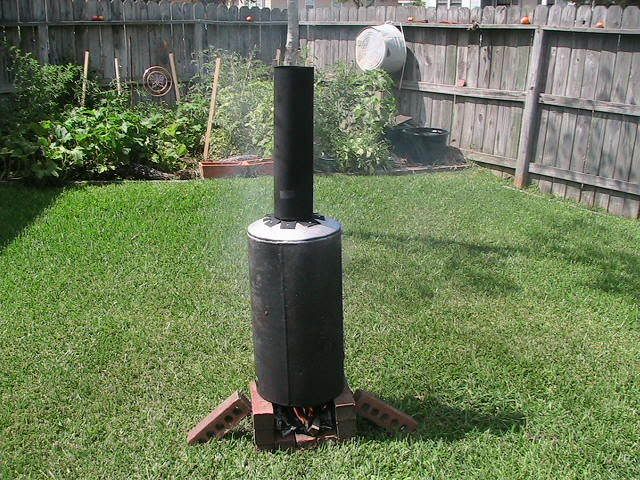

Since I have my gas steam engine. I need to make a boiler for it, I'm going with a monotube boiler made from 2 coils of 60' 1/2" copper tubing. The outer shell for this will be a small air compressor tank. I need some advice on what to do.
Here is what I need help on.
A feedwater pump, this boiler will be mobile so it cant be a water hose. I was thinking a hand pump converted to mechanical by attaching an eccentric.
A burner, I cant use propane but oil, wood, and any other suggestions are welcome.
I'm not a machinist, and I will need some parts made. Volunteers and any help would be appreciated.
I want to get about 120-150 psi with this setup. So can any one help me?Please mam/sir
Best Regards, Ranger Moore

PROGRESS!!!!!
I have got alot done with the shell, heres what I did so far today.
Finished grinding welds off boiler
Painted it black
Ground off the bottom cap
Pressure washed the inside of the boiler, lots of oil and metal gunk
Cut a hole for the chimney, Rough at first.
Smoothed out the hole
Mounted chimney w/ screws,
Painted the chimney
Took it outside for a cleaning test. More on cleaning test after pics
Its ALOT brighter in real life than in the pics, but self adjusting camera doesnt do it any good.
Rough cut hole with a grinder.
Smoothed out hole with air dremel
Simple metal drier pipe for chimney.
Put it on a rolling stand to take it outside, I'm lazy I dont want to carry it that far.
Me standing beside the boiler for size comparasion. I'm about 5' 5"
Took it outside and put it on a brick firebox
Looking down the chimney at the hole, I made the hole small so if I wanted I could make it bigger.
Thrown together brick firebox
I will get a fire going later. This is just the outer shell of the boiler, no copper tubing put in yet. I want to burn off all the oil and nasty crud that I didnt get with the pressure washer. Fire pics will be in a few hours,after it cools down a bit.
rangerssteamtoys is offline

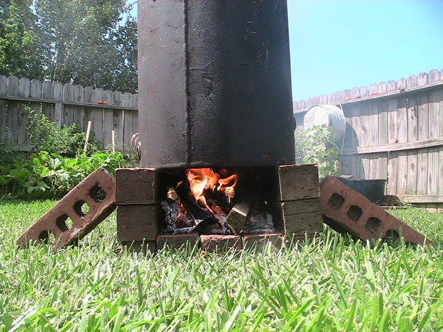

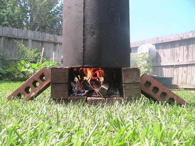

I KNOW THIS IS DANGEROUS
Steam hobby alone is dangerous, I have felt the results before. A monotube boiler is the safest boiler I could find. If the tubing fails, steam and water stays inside the outer shell and doesnt effect me. If it fails in the plumbing going to the engine, the pipes will be insulted and NO WHERE NEAR ME. I will hear the leak and turn on a valve that puts water directly on the fire, putting the fire out. I have about 80% of this figured out. enigne, copper tubing, fire, pulmbing. The only one I havent figured out yet is a water pump, thats why i have a question and the Q and A section.
If you think about a fire tube boiler, well it could send shrapnel no matter what i try to hold it with.
Look here http://www.mikebrownsolutions.com/stmpwr.htm
ANY WAYS
I lit a fire underneath the boiler to clean out the insides of the shell. This still doesnt have coper tubing in it yet, just cleaning the boiler, to get any rust or things like that off.
