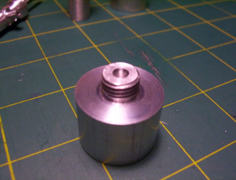

To make the cylinder I used a piece of 3/8" alu.round rod.
I drilled and reamed it and tapped both ends 5/16-24 threads.
Now I turn my attention to the endcaps, I'm using a piece of 1" dia. alu. rod,
After dressing it up (face turning), I then machine a 1/4" spigot.
on the end
to use a die and make 5/16-24, outside thread, which will mate with the tapped ends on the cylinder.
Now a relief cut in the workpiece., to give clearance for ther form tool.
Now I machine down the 1" dia. to around 7/8" dia. This then will leave aroiund 1/4" material above the 3/8 " cylinder.
At my mill I begin the process of drilling the inlet hole and the machining off the sides and later the bottom off this.
Now using the forming tool I form the tube connector.
here it is right after the machining of the connector.
Bandsaw the right amont off.
Now I wrap plumbers tape around the threads and screw it on to the cylinder, and place the whole assembly back into the lathe for machining the finishing on the endcap.
Now drill and ream for the piston rod.
Still have the bottom cap to make yet.
But here is what it looks like with the tube connector machined into the endcap, rather then the cylinder.
Next is the making of the bottom endcap.

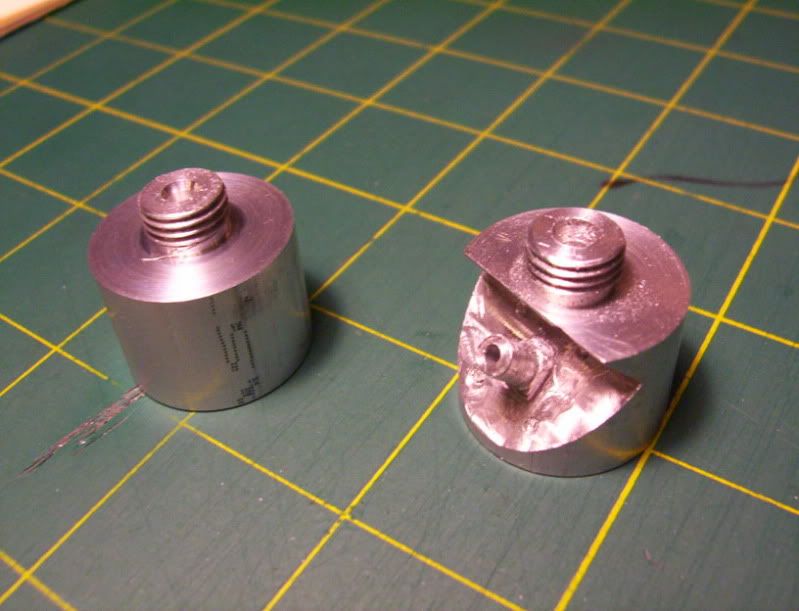

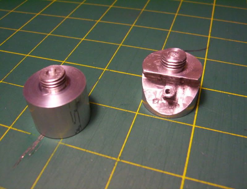

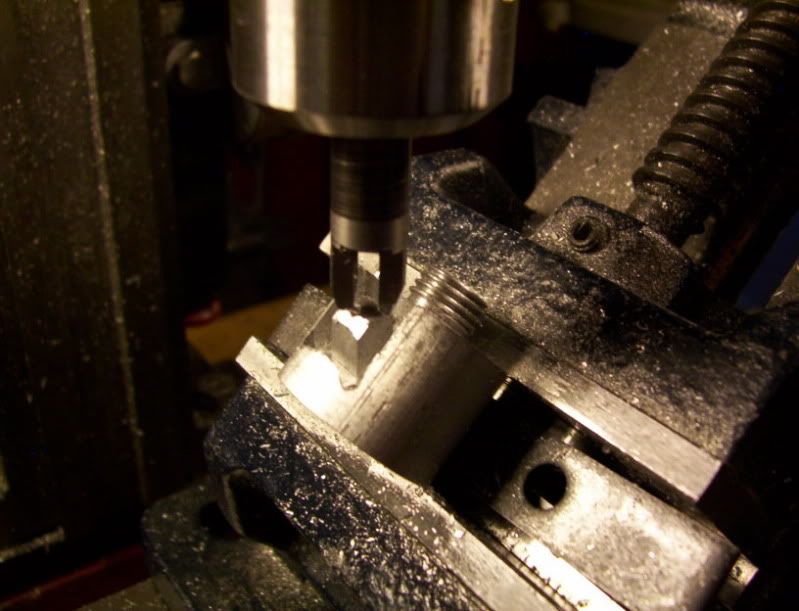

I'm making the bottom endcaps for the manual pumps, cylinders,
again the spigot will be formed on the cap as one piece, however this time the spigot (tube connector) will be elevated at 45*, so as to accomodate the tubing in more of a vertical configuration to the cylinder, rather than perpendicular to it.
I started out with 1" dia. alu. round stock, cut and machined to finished length.
Then a nub is machined onto it and threaded for 7/16 20 to mate with the bottom of its pump cylinder.

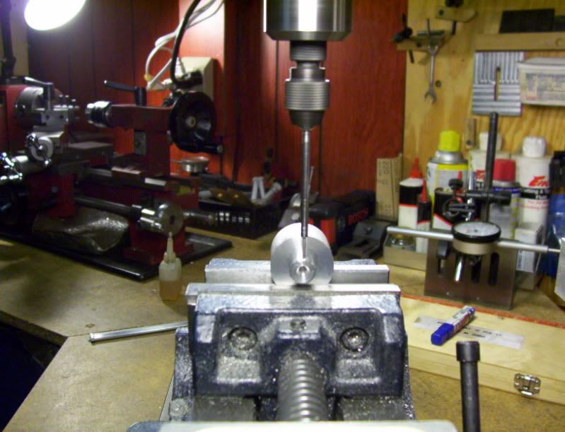

Then I center the spindle in relation to the center of the workpiece.

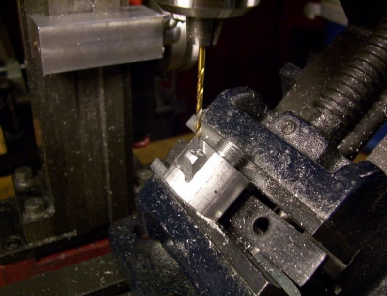

Vice tilted to 45*
First machine a flat that will be the top of the spigot.

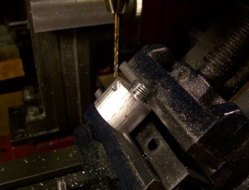

Now drill the output hole for the spigot later to be machioned. Also this hole serves to line everything up as a reference, later when I need to get back to center for the final forming of the spigot.

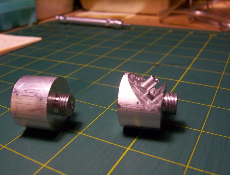

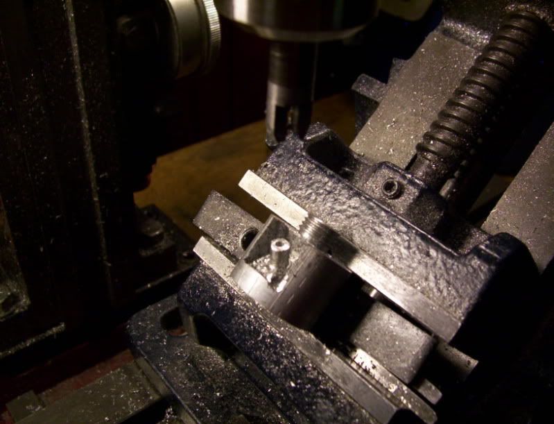

Now I drill 4 reference holes to guide the 1/8" milling bit to rough shape out the spigot.
Now with the endmill, mill out the rough shape, of the spigot.
Back to centering up the workpiece under the spindle using the drilled hole as reference.
Now the finish forming of the spigot.
After milling out all the material around it.
And with the manual pump cylinder screwed onto it for a test fit.
Testing it's performance with the hose connected.
Next is to finish the other pump, endcap base, then start working on the pistons and such for each manual pump cylinder.
