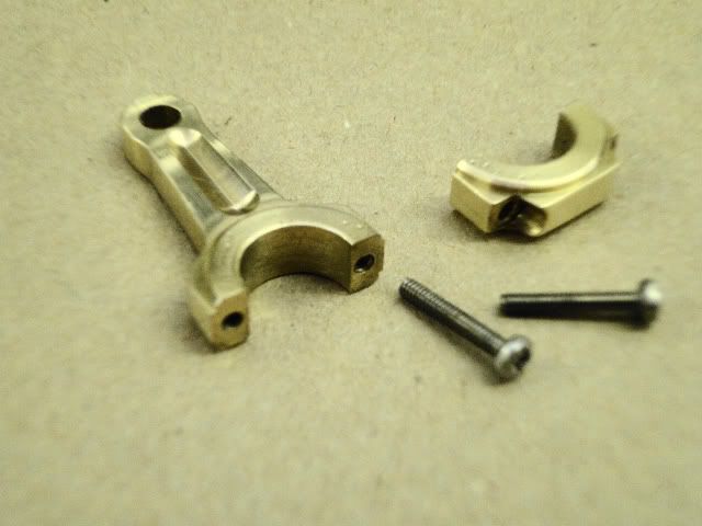

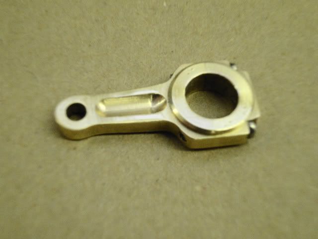

I made up a conrod, just to see if I could! The screws are stainless M2 panheads. Pictures of my method will follow when I make the rest.
Ian

Ian- If that con rod is any indication, this will be a very nice looking engine. A two stroke with 4 into 1 exhausts
should sound great.
Mike

Very nice job on that con-rod. Did you use any jigs, CNC, or

No jigs or CNC on this one, just made it up to see what problems there were.
