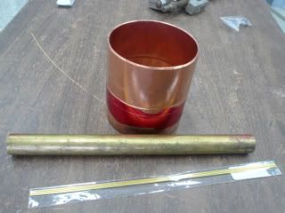

The rear wheels are supposed to be brass, 4 1/2” OD & 4 1/4” ID, fabricated from a cast-brass pipe adapter. Good luck finding one. The closest I could come in brass was a threaded specialty connector for $148 and I would need two!! I’m barely started and I have to deviate from the plans. However, I guess being able to do that is part of the beauty of model engineering and of not building an exact replica. Anyway, I ended up selecting a 4” copper sweat fitting that is 4.350 OD and 4.136 ID. Close enough. Thirty-eight bucks, but I get two wheels from one fitting. The other raw materials are 1” brass rod for the hub and 3/32” rod for the spokes.

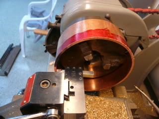

For the rims, I cut two 1 1/2" wide rings from the coupling.
Since I’ve only got a 6” lathe, I had to get creative to face the edges (Rudy says this can be done with a file!?).

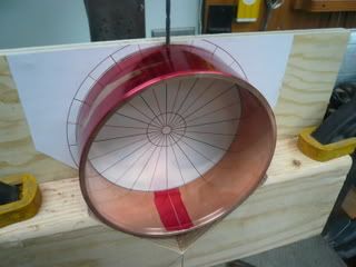

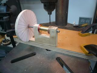

Next step…spoke holes. There are 24 spokes per wheel, twelve to a side, staggered so the two sides are off-set. To drill the holes I layed out the spoke pattern and glued it to a wood fixture (I’m a big fan of wood for one-time fixtures). The way this one works is the black lines represent one side’s spokes and the red the other. Line up the reference line on the inside of the rim with either a red or black line, drill, move the reference to the next line of the same color and so on. Then reverse the rim and drill the other side using the opposite color lines. I first spot drilled and then thru drilled.
Drilling the copper didn’t go so well until I got some info from helpful people on this board (see thread on “Drilling Copper). The trick is slower speed (1000 rpm or slower) and coolant (preferably tallow).
Each wheel has 24 “grouters” fastened with rivets. They’re fastened such that two of them fall between each spoke. Rudy’s suggestion was to drill the holes on one side of the rim and then use the grouter as a guide to line drill the other side during assembly.
The rivets will be 1/16”, but I used a #51 drill which makes it just a little easier to get the rivets in. I used the same drill fixture as for the spoke holes, but used a new reference line set off the proper distance from the original reference. Then I aligned the new mark with each of the spoke lines, spot drilled and then thru drilled.

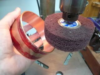

After the holes were all drilled, I deburred the inside using a 3” diameter scotchbrite wheel in the drill press.

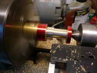

The hubs are a basic turning operation. They’re drilled 0.250” and there’s a 6-32 set screw in the center of the hub for securing the wheel to the axle.
The spoke holes are drilled to match the holes in the rims with 12 spokes per side staggered so the two sides are offset. I used a locating method similar to the one used for drilling the rims. The fixture is positioned on the drill press for the first side. Twelve holes are drilled using the black lines for reference, then the fixture is re-positioned for the second side and the holes are drilled using the red lines for reference. Holes were spotted with a spotting drill and then drilled. The hub is 1.5” long and 1” diameter. Spoke holes are 3/32”.
Wheel assembly tomorrow.
