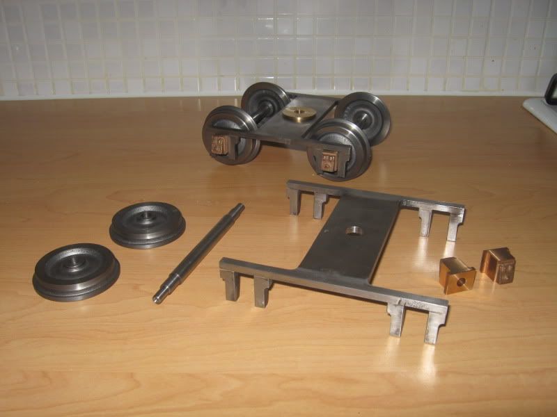

Ok, first post here for me. Been a long time browser and lurker but thought I'd finally take the plunge and post something!
This is my first proper model engineering build and is being a steep learning curve. I have never had any training in engineering (other than a 'A' in design technology at school) and my further education and work line is all laboratory based.
This all started four years ago when I was into model steam (Mamod, Wilesco, Jensen etc) and I was tinkering with them. I managed (successfully) to make a double acting slide valve cylinder for a Mamod traction engine using nothing but a drill, files and pure determination.
I was then sold an ageing Emco-Unimat SL1000 (the motor promptly blew and was replaced with a sewing machine motor!) and I started making proper chips.
At that point, someone offered me a project. A LSBC designed 3.5 inch gauge (3/4 scale) American Virginia steam locomotive. All that he had was some part turned driving wheels, part machined cylinders and some rather uniquely dimensioned (read 'slightly not to drawing') frames.
To cut a long story short (and it is a long story!), this is where I am now using my trusty Unimat and a friend with a lathe who bored the cylinders and tread-ed the wheels:
(forgive the clutter)
And here are some components in various stages of manufacture:
The boiler is commercially made (Cheddar models UK) which I bought second hand but unused with certification for 1/4 the cost it should have been. Other than that I have made everything you see there other than the two domes (I got with the boiler), the treads on the wheels and the cylinder bores. The frames were the ones cut by the previous owner but I have reshaped them and they do have a few erroneous holes (but they're well hidden).
And the best bit about all this so far? The chassis runs on air! (well, from a bicycle pump. One pump give about 2/3 turn of the wheels.
My next goal is to find an engineering club and get the boiler properly tested and fired up! And maybe finish the tender...

That's looking really nice, and you are making all your own fittings rather than go out any buy them.
What is the purpose of the jig?
I'm looking forward to seeing more
Pete
I chose to make my own fittings as practice due to my lack of experience with a lathe. It also helps me understand how they all work. The own thing I will buy however is the injector just so I know it works when needed!
The jig? I assume that you mean the large metal frame in front of the engine in the first photo? If so, that isn't a jig but the tender frames and two bogie (truck) frames. The whole thing is upside down in the picture. I've recently moved on with one of the bogie's and looks like this (with some in progress parts):
LBSC says to make the tender frame by bending two lengths of steel into long 'c' shapes and riveting them together. That didn't sound strong enough to me so I just used two lengths of steel bolted onto two 0.5" drag bars (all made into the same dimensions).
He also says that the bogie frames should be brazed together from eleven parts in one go! My small butane blowtorch was not up to that so the top frame was cut from a 6x7 inch 3/16" steel plate rather than fabricated and the horns silver soldered on one by one by eye without the use of a heat sucking jig.
I've also gone against convention by part maching the wheels, fixing them to the axles then finishing the tread.

Thanks for the update, it obvious now you explain its the tender frames. It looks like you are doing a great job there with what sounds like constrained condition's to work in.
