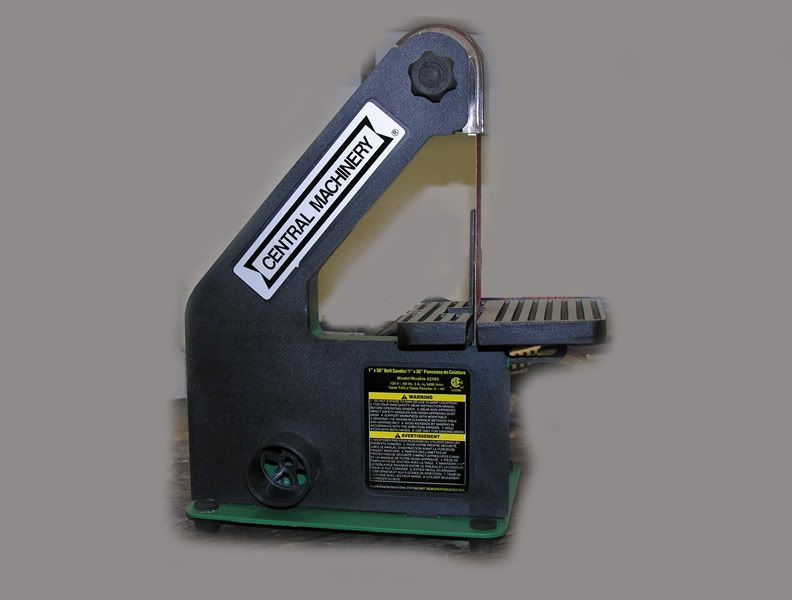

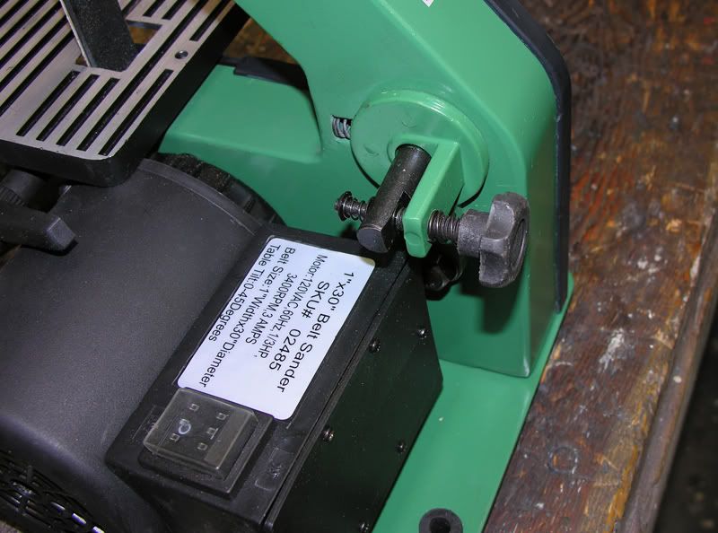

This also gives me a chance to post some pictures of the machine for the forum, for other customers (victims?) like me.
Off to HF to spend money: It wasn't on sale that day, but $45.00 was still OK. I also got a couple each of the two grits of belt that they sell.
Once I got home, I opened the box to the usual broken-styrofoam packing and got the sander out to start taking pictures. The shop was too messy and I didn't feel like doing studio work, so the photos have been heavily modified so as to focus on the sander.

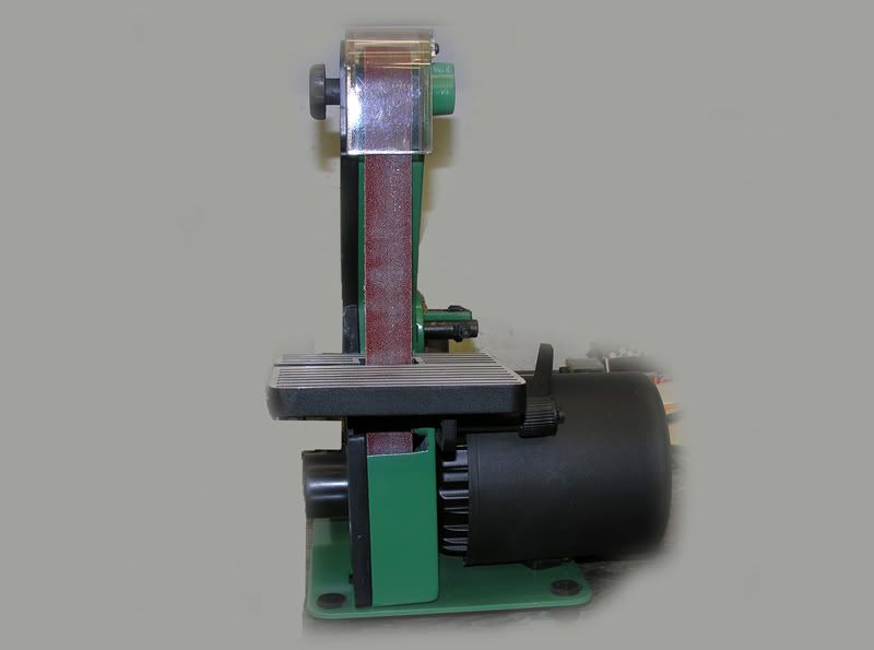

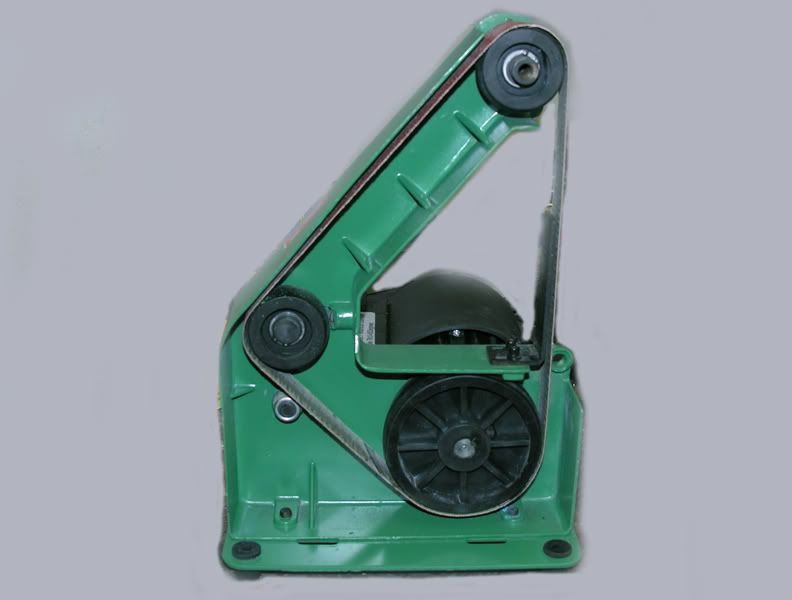

First Surprise: The sander is green, green suspiciously like someone else's green!!!

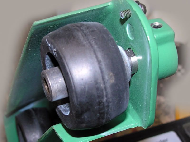

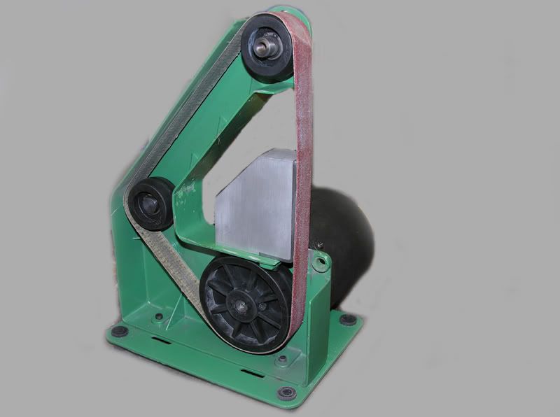

The belt rollers are heavily crowned and made of plastic. The top roller is on a shaft that is secured to the casting with a socket-head setscrew: Mine was extended way out so that only the end of the shaft was secured by the screw.
The two smaller rollers have metal inserts. The large motor drive roller does not have a metal insert, but is secured by a setsrew at an awkward angle: MIne was on the verge of stripping: I'll deal with that later. The rear roller has an insert and is secured to the adjustment shaft with an outside circlip. The adjuster is on the motor side of the sander: Mine was "out of adjustment range"

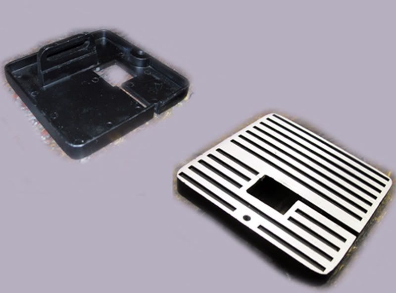

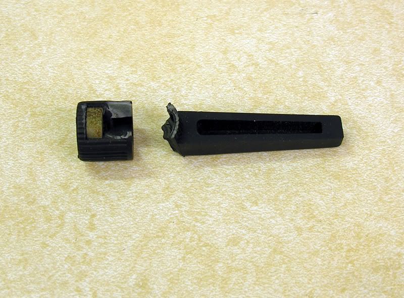

The toolrest is a rough alloy casting with deep slots on top and a large slot for mounting one of those spring-tensioned adjustable knobs. The lever on the knob that I received would not pull out far enough off the rest of the nut for setting it to a convenient angle without having to remove the screw and spring. Something else to deal with....
There is a hole at the top of the stage casting for another setscrew that is for setting a level stop position for the table: I did find the setsrew loose among the shredded styrofoam in the box later.

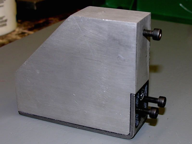

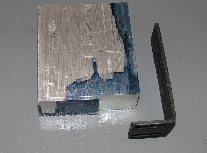

I set the sander up and ran it briefly. It seemed to have adequate power, but right away I found that the platen behind the belt is too weak and flexible to be useful. I expected this and I had been considering several alternatives. Following CFellows sander modification using a ceramic material, I thought about using that: I read his link to the vendor of this material and was duly awed and scared by the safety notices. Since I have lots of Murphy's-Law days I decided I did not want to do that. I look at this project as a learning and experimenting exercise, so maybe doing another, bigger sander later will be the time to look at that.
I really like using aluminum and I happened to have a piece of 1 x 3 6061 bar. I considered ordering some steel or cast iron and maybe even trying to do some hardening, but ended up deciding that would be too much to spend and too much to deal with for an experiment that might not lead anywhere. In the end I decided to make a heavy block from the 6061 and mill away part of it to fit the original platen.
The original platen was "massaged" to fit carefully and a countersunk hole was added to secure it to the aluminum block. After doing this with a 6-32 screw, I remembered that I should try to use more metric on a project that is already metric, just to avoid confusion. Three 4mm holes drilled and tapped for socket-heads.

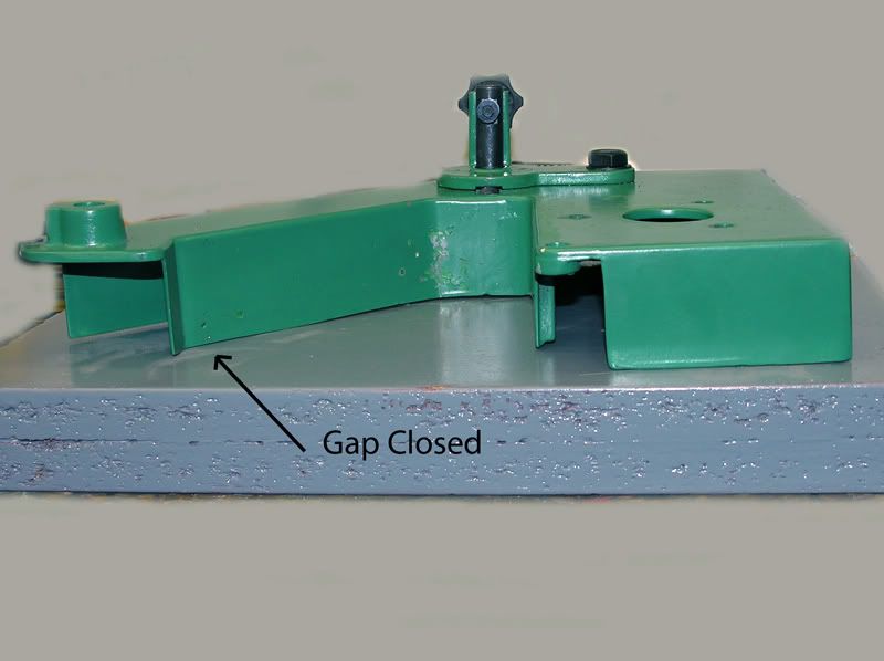

At this stage I started wresting with the locating and securing of the new platen and ended up deciding that I would have to try to deal with the belt-tracking issue. This project is an experiment, so I was happy to proceed without going back to HF.
Here's what I found:

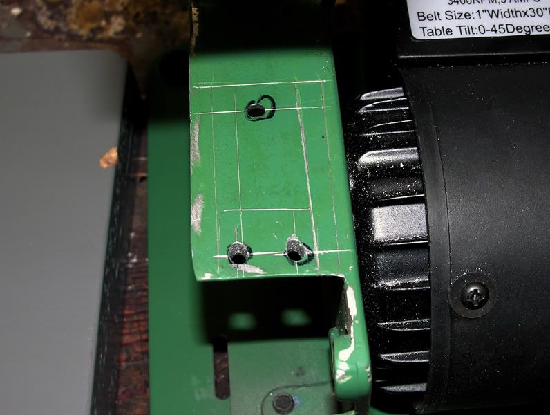

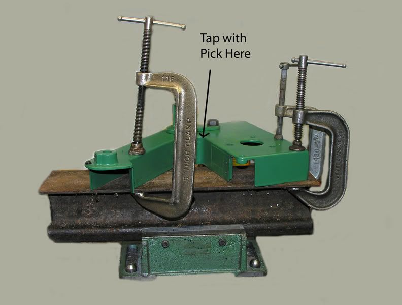

I have had lots of practice bending and straightening things, so I approached the problem by clamping the casting to a piece railroad iron (doesn't everybody have one of these?) and used one of my autobody pick hammers where the "arm" meets the "base"
It worked. But is the casting metal so bad that it'll come back? Time will tell.
Back to the Platen: Finally settled on a location and drilled the holes: Started rough holes and filed to fit and adjusted as I went.
Some tests without a stage confirmed better support and rigidity. I think I'll hack away part of the existing toolrest (stage) to fit around the new platen block and get some different types of belts on order so I can report back.

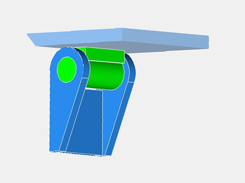

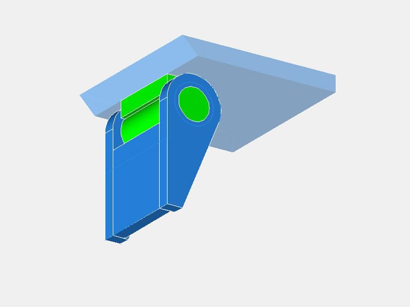

I'm thinking about a new toolholder similar to these models. I see this sander as mainly for sanding parts, not sharpening tools: I am pondering some type of a positive-stop system to the new stage for adjustable, but repeatable, results. I could also just end up with some type of calibrated setting with a strong lock knob. I'll report back when I get more done.

I had forgotten about the Grizzly tool rest. Thank you for calling it to my attention. I did think of the gap in the design I am contemplating and the table would slide to and from the belt as well as the table tilt. The intent was to actually mount it to the sander. I'm still thinking. The 3D model is not a plan for construction in any way, just a way for me to present my train of thought at the present time. Thanks again for your input.

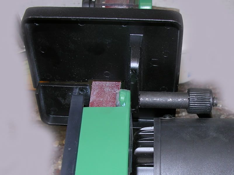

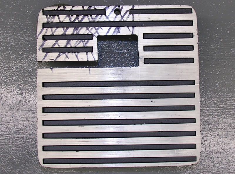

Now that I've had a few more days on this project, It's time for an update. I cut off the corner of the stage as I was planning. Since I want to use this sander for finishing small parts I found the grooves in the existing table a hindrance to locating work and decided to cover the table with sheet aluminum to use it as I work on an alternate table. The aluminum was an unknown piece from an electronics minibox, so was soft, but OK for testing purposes.
I put the stage back in place with original hardware and set it square to the belt. I had trouble locking the table in place when the original plastic lever broke off with only minimal torque.
Yet another reason to make a better table! For now, tighten it in place with pliers.

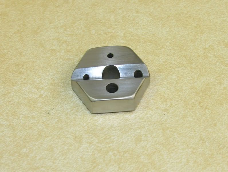

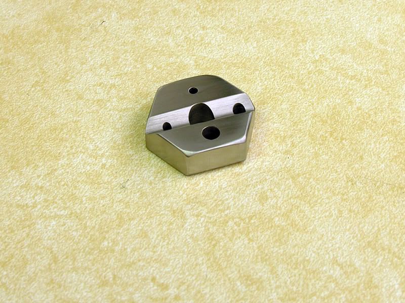

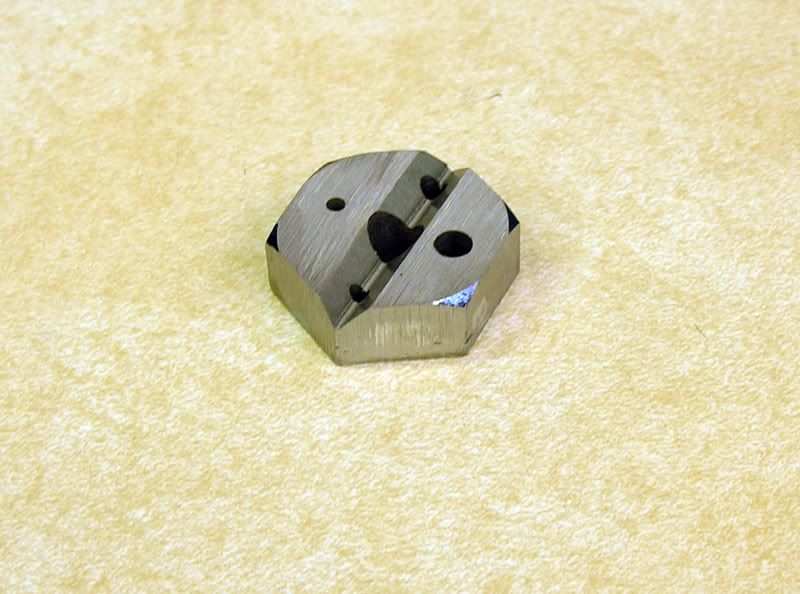

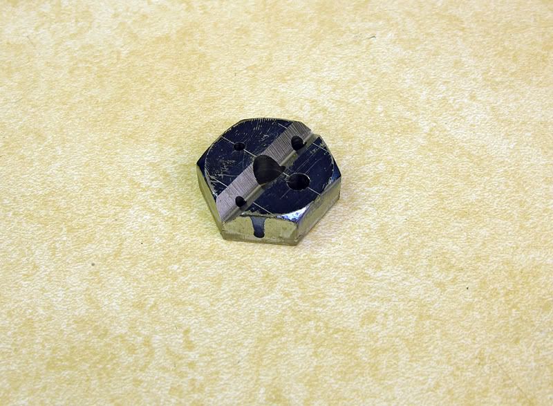

I had a head cut off a cheap 1 inch bolt in my junk box that I decided would make a useful bench block and decided to use that as a test for the sander on steel. I milled the top and bottom of the bolthead and laid out a groove and some holes and milled and drilled them in the piece. I did this quickly, so I'm a bit embarrassed with the precision, but "This is only a test..."
Over to the sander and quickly work the faces with an 80-grit belt.
A little file work and then the 120 Grit belt.
240 Grit
320 Grit
There are "Deburring" belts available similar to the scrubbing pads sold by 3M and others, so I installed one of these in the "VF" grade and tried this. I had to relieve some more of the housing casting here and there in order to fit this belt so that the wheels would not bind.
This stuff was fun to use and I stop here, even though I could follow this with the buffer and buffing compound.

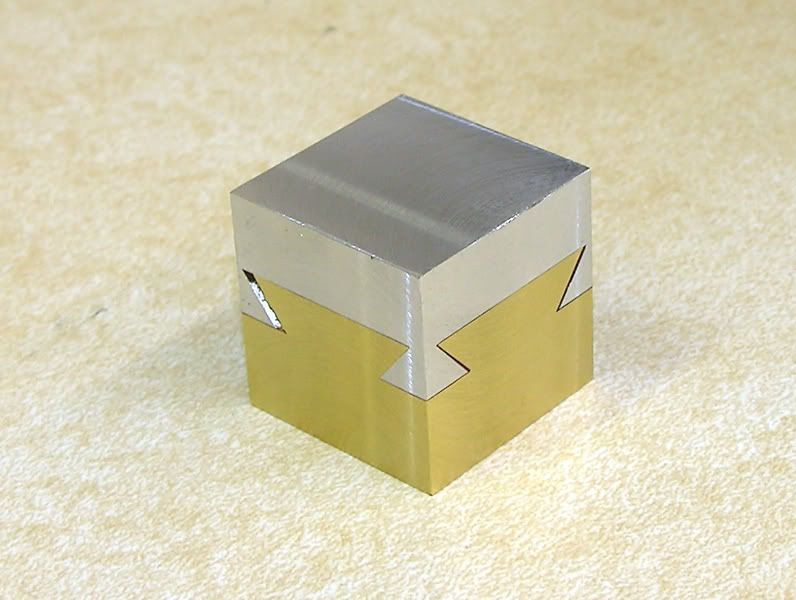

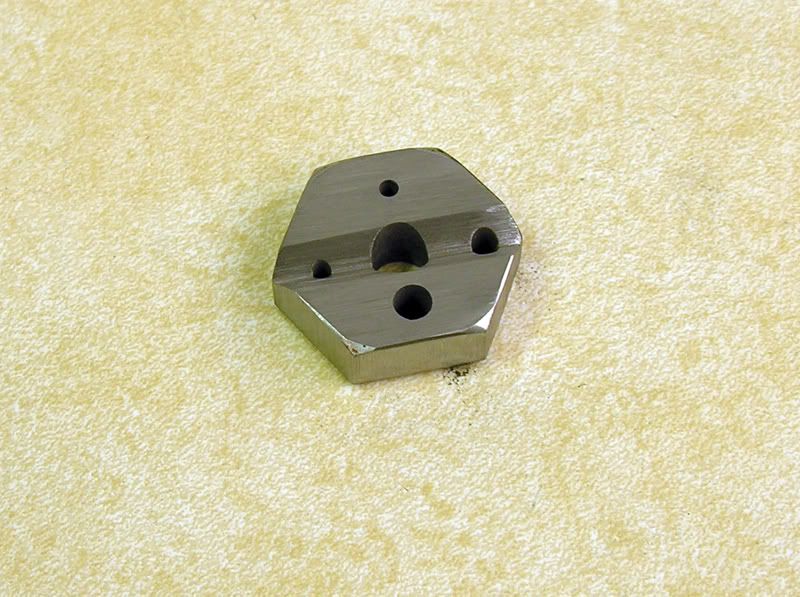

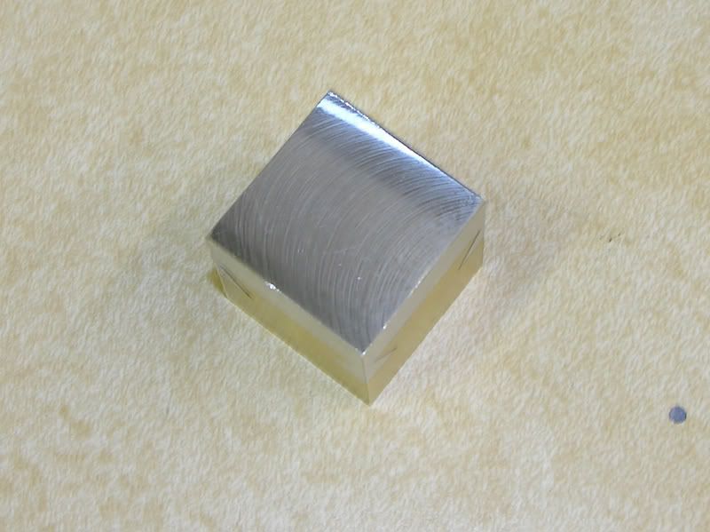

For further testing, I made up a puzzle block with brass and aluminum. Once again, speed over precision and I'm sorry about that.
Right out of the mill:
Out-of focus shot of block top showing toolmarks.

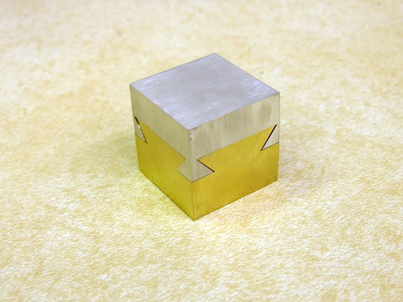

Over to the sander to work with the 240-grit belt:
Following up with 400 grit on glass plate and then the buffer created a very nice finish., which I won't show because I managed to drop it on the concrete floor and ding it up. I decided to stop and write this post before more mishaps: Did you ever have one of those days?
