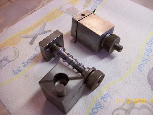

Guy Lautard "The Mchinist Bedside Reader", (first book of three), has a small fixture in it that he built to sharpen 1/8" to #60 drills. I could explain it but probably I would get carpral tunnel from typing.

Drill Doctors are cleverly designed reading comprehension tests. I've yet to encounter a DD I couldn't make sharpen a drill by following the directions carefully. No, they won't sharpen #60 and like drills. For these tiny drills, the best solution is to sharpen with flat facets rather than trying to grind the traditional conical tip.
IIRC, Lautard's device makes flat facets but it, like so many of his projects, is overly complicated. There are simpler devices. Mine is nothing more than two pieces of steel which clamp together and hold the drill, point exposed, in a V-groove. Flats with the proper compound sharpening angles are milled into the ends of these steel bars. A small diamond stone slid over these flats produces the proper facet on the drill end.
Another approach I've seen employs a pin vise attached to a piece of angle. The angle provides guide surfaces for rubbing the exposed drill tip on a diamond plate. My HSM index reports an article in 11/12-1987 issue by Trevor Robinson which may be this device I'm too lazy to dig out the mag and look).

Old 01-19-2008, 03:40 PM   #8
Tom T
Join Date: Sep 2007
Posts: 121
Liked 36 Times on 32 Posts
Default Re: sharpening small drill bits
Here is a picture of Guy Lautard drill bit sharpener.It was one of my first projects.Tom
