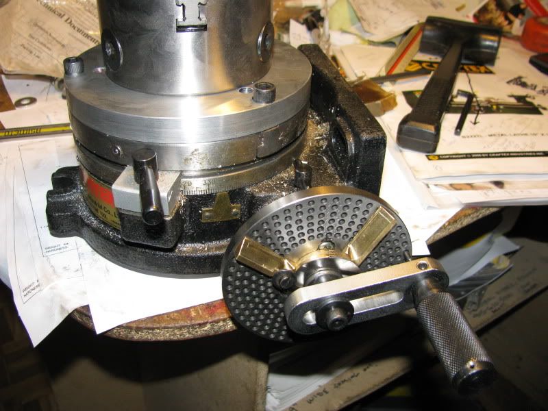

Today I washed all the cosmoline gunk off my Divider plates which came with my rotary table (which I purchased 3 years ago). I followed the Chinglish instructions, and after slotting the holes in the divider plates so they would actually fit the bolt pattern in the rotary table (Thats a whole 'nuther story) I was able to assemble things okay. I am beginning to figure out how the divider plates are supposed to work---fortunately I am using the rotary table to cut an eithteen tooth gear, which means 5 full rotations of my handle to accomplish the 20 degrees between cutting positions, so I can use any of the divider plates. (Mine is a 90:1 gear reduction).----Now the question---Those brass arms (I think they are called "sectors") have a screw, which when tightened will lock the angle between the sector arms---However, the two arms (now locked at some angle) seem to rotate fairly freely on the center hub.---They shouldn't do that, should they?? If I am doing some exotic pattern that calls for X number of full rotations and then count how ever many additional holes in the divider plates to let my spring loaded handle pin drop into (Which I THINK is supposed to be located by one of the sector arms)---and the arms rotate out of position---then I'll end up dropping my spring loaded pin into the wrong hole. What am I not understanding here---Brian

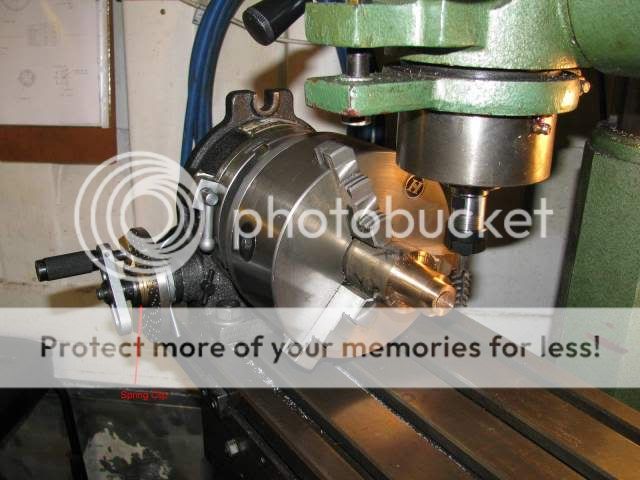

Brian,
In the dividing plate set there is a largish spring clip which locates in a groove in the shaft and prevents the sector arms from rotating freely. They will still rotate as they must but with some resistance.
Looking at your picture you seem to have it fitted but maybe it needs bending to tighten things up a little.
The pin should be inside the sector arms and the sector arms should be set to the number of holes required + 1. e.g. X turns + 10 holes, the sector should be set to 11 holes on the appropriate holes circle.

The two arms should rotate freely around the hub but not too freely.
On my RT there is a half moon spring between the arms and the hub that keeps tension between the two.
If your divider plates don’t have a spring, thy are very easy to lose or it may have came without one you mite be able to put a peace of paper or even some tape between the arms and the hub to give you the friction you need. Or you may be able to dill & tap the ring on the arms for a small set screw to give some friction.
On the divider plate you mite want to put a mark on the top of the plate at the hole that you will be using with something like a Sharpie pen so you will know where you are. When going around the plate for the next tooth if you should go by where you want to stop, you will want to take a full turn in the opposite direction to get red of any back lash then come back to where you wish to be.

Let me see if I can explain the use of the sector arms.
With a 90:1 RT, you have to turn the RT handle 90 full turns to make the part turn one complete revolution. Now let's suppose you want to make a 21 tooth gear. That requires turning the part 1/21 revolution for each tooth. That means you have to turn the handle
(1/21) * 90 = 90/21 = 4 & 6/21 turns
for each tooth. That's four complete turns of the handle and 6 spaces (note I didn't say holes) on the 21 hole plate.
Put the pin in one of the holes and bring the beveled edge of one of the sector arms around to touch the left side of the pin. Now, counting the hole the pin is in as zero, count off 6 holes and place another pin. Verify that there are indeed six inter-hole spaces between the two pins. Bring the other sector arm around so its beveled face touches the right side of this last-placed pin. Tighten the locking mechanism that retains this angular separation of the two arms.
Now, when you want to index, swing the locked sector arm assembly so as to put the beveled edge of the sector arm pair against the left side of the indexing pin. Pull the pin and turn it 4 full turns, then continue to the hole that lies next to the other sector arm on the 21 hole ring. Voila, you've moved the handle 4 and 6/7 turns and you only had to count to four. Really, once you understand it, I think you'll agree that it's a very ingenious mechanism.
For any other gear, with N teeth, simply compute:
90/N
and express it in a fraction with a denominator that matches the number of holes in one of your hole circles. Then proceed as above to set the sector arms.
