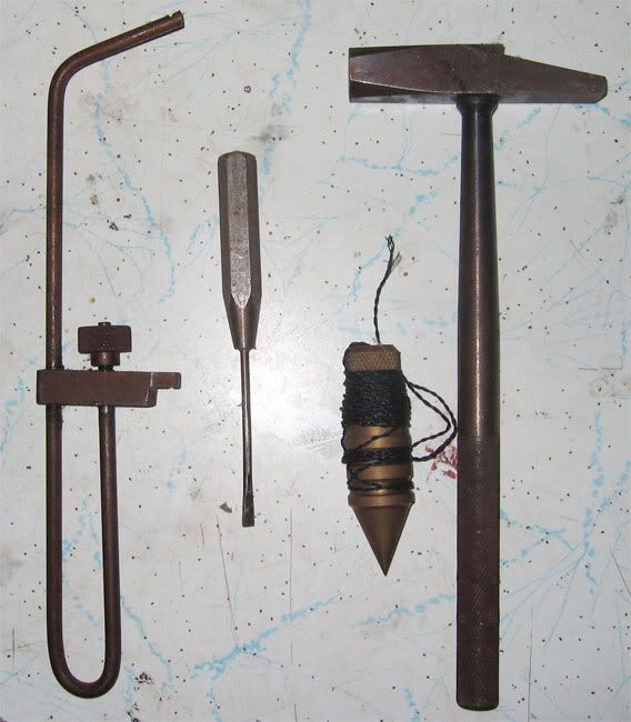

I remember doing this in high school and know it involves heating up the steel item and plunging it into oil but can't remember the finer details.
I've done a quick search but can't find anything here on it.
How hot do I need to heat the steel?
Will any oil do or are some better than others.
I'm making a simple tapping tool and want to give it a black finish and if I remember correctly the oil black finish inhibits rust a bit too.
Thanks
Tony

To be honest I hadn't really thought about how black.
I found a hammer I made back in high school some 20 years ago at my parents house a few months back and it I gave an oil black finish and consider it just has sat on a shelf for the last 10 to 15 years and it has hardly any rust I was planning on doing the same to my tapping tool.
This is my 20 year old oil blackened hammer I made in high school along with some other tools I made back then.
I'm looking for a similar finish to the hammer.
I'll now head over to the download section and check out the recipes.
