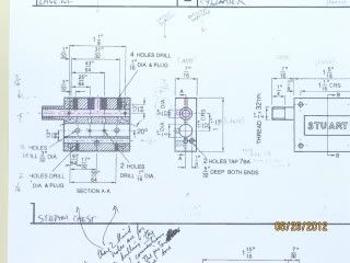

Has anyone here done the little S-T pump? I have a question about the function of a steam passage shown on the print.

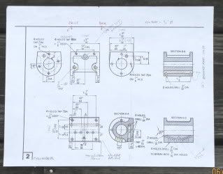

The pump is a single cylinder steam pump. The 2 pictures below are from the print that came with the Stuart turner castings. It does not have a number or a date, but it is an original ST print.
The upper picture shows the valve chamber. A mystery to me has to do with the 'T' shaped passage I have hand-colored in red, somewhat faintly, on the left side of the drawing. The short vertical stem of the 'T' is the steam-in to the pump. The longer horizontal part of the 'T' shows two very small holes, one on the left and one on the right, drilled at right angles to the longer horizontal part of the 'T'. They look like little black dots on the print. What are those 2 holes for?
The second of the two pictures shows the cylinder to which the valve chest mates.
Sorry about the miserable resolution of the photographs. I can no longer get Photobucket to behave as it used to. Doing a digitized scan of the print might be the right avenue for conveying a clear image.

The conclusion that I came to is that it is the steam inlet (the small piece of the 'T') and a spool (piston) valve goes into the long part of the 'T'.
As the piston valve is moved in and out by the piston rod of the main cylinder (going to the pump itself) it will feed steam to either end of the cylinder, making the piston go in and out. Basically, a piston valve engine.
So turn on steam, and the unit will just go backwards and forwards, driving the pump on the other end of the main piston rod, whilst at the same time, moving the spool valve so that feeds steam to the top and bottom of the piston and so on and so on and so on......................... continuous motion, and water pumped, until steam is cut off.

The valve worked from this piston rod controls a loose shuttle valve which in turn controls the steam distribution to the
cylinder. I have not made one of these (though I have often thought of doing so - some time) so I cannot be of more help without
a better look at the drawings, including the valves.

In answer to your question ( WHAT ARE THE 2- HOLES FOR ) the 2- holes that you wish to know about are exhaust ports, they link up to the 2- holes on the face of the cylinder and connect to the exhaust outlet via the 'T' shaped dotted drilled holes going to the 3/16 x 40 tapped outlet.
If you look on the cross sectional plan of the steam chest the 2- 20deg holes coming in from each end of the 1/4" dia shuttle valve hole this carries the exhaust from the piston up thro" the shuttle valve and then transfers to the cylinder exhaust holes.
When you make the 5/32" dia auxiliary valve keep the edges a sharp as possible with dimensions strickland to the drawing, like wise on the shuttle valve.
Hope this answers your question.
