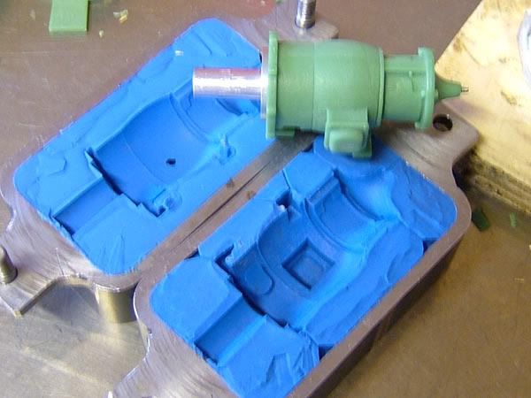

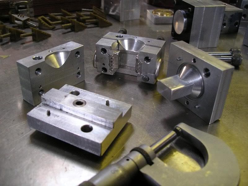

Hi Rob, the drill press has been converted into a high pressure wax injector , the wax is melted by a small cartridge heater in the reservoir - the copper tube part on the side - and drawn , via a non-return valve , into the cylinder which replaces the quill.
Pressure is applied by the long top handle onto a piston and the wax is forced into a die ,placed on the table ,through the bottom valve. A band heater keeps the nozzle and ram at required temperature using simple temperature controllers.
Injection pressures of 200 psi are possible and dies are machined from aluminium , or cast from low melt alloy(woods metal) , or sometimes silicone rubber , even chemical metal can be utilised.
the combination of pressure and die produces consistent dimensions in the wax patterns and castings allowing holes as small as 1\16" to be included in the casting , thin wall sections are also more easily reproduced allowing castings to be made that require minimum machining
