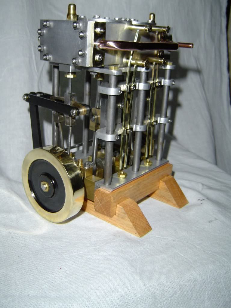

I know this thread is about efficiency, but one of the drawbacks to a compound engine is since the cylinders are in series, they are not necessarily self starting and have the same "dead spots" as a single cylinder engine. On a model that is static run on a display this is not a problem but if one wants to put an engine in a radio controlled model boat or a model train, this can create problems. The real world solution was to put a "simpling valve" in the low pressure line which would allow boiler steam to directly enter the low pressure cylinder and effectively start as a simple two cylinder engine. After the engine was running the valve would be closed and the engine would continue to run as a compound. I built this compound a few years back based on Rudy Kouhoupt's design. I played with building a simpling valve for it and finally moved on since I did not have any plans on putting it in a boat.
