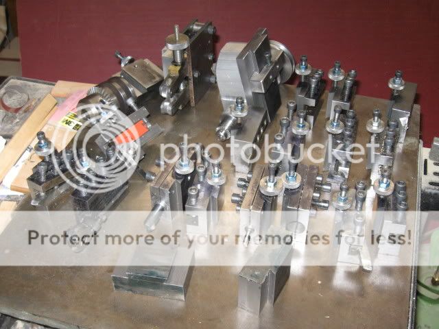

Old 06-16-2009, 05:23 PM   #27
DavesWimshurst
DavesWimshurst
Location: Batavia Illinois
Posts: 102
Liked 7 Times on 7 Posts
Default Re: Making a QCTP (Quick change tool post)
Phil,
Leaving a little off the sharp corners of the dovetails would make the tool holders less vulnerable to damage from bumping into other tools, maybe truncating the corners of both the post and holders will work.
Your tool post looks like a really solid design.
You can never have too many tool holders:
The two in the back for the knurling tool and the milling spindle are built into the accessory. The dovetail for the knurling tool is of aluminum since it doesn't have to relocate accurately. I also used aluminum for a test indicator holder.
Hi Dave,
Now I've got a serious case of tool post envy.
After a good nights sleep and another think, I think I will truncate the corners a bit and also reduce the dovetail depth on both the holder and body. I could always buy the next cutter size up, but that would be more waiting and the cutter would be cutting on both sides in the first few passes.
The TI and knurling holders are a must do.
Thanks again guys

Old 06-17-2009, 04:48 AM   #29
DavesWimshurst
DavesWimshurst
Posts: 102
Phil,
I had recently bought an atlas shaper and was looking for an excuse to use it!
DavesWimshurst is offline
