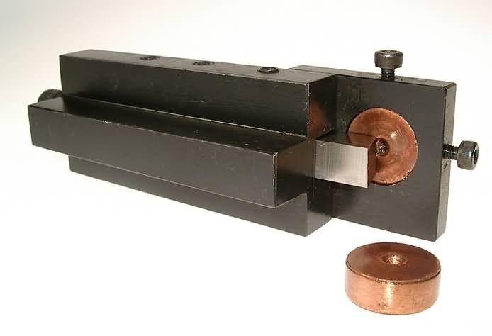

This is my version

Posts: 1,177
Liked 31 Times on 31 Posts
Default Re: Box Tool aka Small diameter turning tool
Tel ............ ................ excellent, I take it you use different size bushes depending on the required size of the "end product" ......... tell the 'ed Wombat you deserve a raise mate
Thanks mate!
Yes, the size of the stock dictates the bush size required. The only restriction is that you have to be able to make the reduction in one pass. Very handy for making small screws & rivets tho'.
In passing, for small stuff like this I usually use brazing rods as stock, available in a range of sizes, in manganese and tobin bronze and cheaper by far than the 'usual suspects'.
Actually that's wrong isn't it ........... the bush is dictated by the diameter of the material being fed, and as you say you have to reduce it in one pass, so several bushes .......... varying diameters, (in small steps) would be useful ....... it's slowly sinking in Tel
CC

I can see that you have adapted it from a BOX tool, now how do you part-off the finished bit, when you got that fixed to the cross slide?
If you had made it so that it was fixed/adapted to fit to the tailstock, then the parting-off tool would still be able to be used.
Made up these two little jiggers to fit to a Unimat 3 tailstock, they do the same thing, I use lots of 10 BA and 12 BA bolts, With these in use on the tailstock, then the parting-off tool can still be used. Use the bronze rod as well, it's sure the cheapest way to go.

We're talking tiny rod. A pair of side cutters do the job quite well. 1/8 inch Bronze rod is $9.99 for 21 feet in Northern Tools' welding supply area. Picked some up a few weeks back. You're right....very handy to have around.
Thanks Tel and all... thats the tool and its nice to see the variations. I wonder if one could mount a small die right on the tool and turn it straight to threaded rod.
